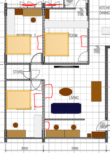

@007Mi6 , this is the floor plan. Bedrooms is quite straightforward, nothing to shout about.
It's more of the living room area. Ideally I want to have 2 units so that I can just cool the study area without blasting the entire 24k FCU for whole living space (if doing without partition).
But the opening of the study area makes it challenging to mount a door of sorts due to the long living room windows all the way to near the entrance. Which is why I thought maybe I just leave it open, and install a corner fan above near the main door area and blowing backwards the cool air towards the inner part of the study area.
Not the best solution but beats cooling the entire area or just let the cold air "slips" towards the living area through the front foyer?
Another position I can think of to mount the living room FCU is via the master bedroom above the TV area, blowing downwards to dining + sofa. I will also have a ceiling fan in the middle to create ventilation.

ah stand ard design.
1. doesnt make sense for master to have the FCU sited there. just put it over the window. short pipe runs and still blowing at the bed. bed3 also at window
2. i would place the living FCU at the TV wall. unless your TV is wall mounted and fixed, then maybe avoid that area. reason being shorter pipe lengths and FCU blowing at sofa.
3. bed 2. i would place the FCU above the door. room is small and still can blow at the bed. avoid the trunking along the wall.
4. for the study not sure how to aircon. it is such an odd area. i think the 18k at living is good enough. then use fan to blow. not sure, just think the odd location of study make the aircon placement more difficult. you have a super long pipes to the compressor and drainage.
maybe his wall all the way up to ceiling, yes place 18k on living and use any stand fan , easy to blow in cooling air.
