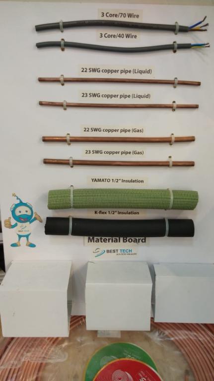

anyone have feedback on the Daikin Yamato insulation ?
https://forums.hardwarezone.com.sg/threads/anyone-hear-of-daiichi-pre-insulated-insulation.6901552/
https://forums.hardwarezone.com.sg/...please-part-2.5671374/page-231#post-127542027
not much data on them. the only pro i can think of they usually are in 1 pc . which rule out gap when installer joint the insulation together
and those are japan market, and sg weather is very very different from japan. but i would have choosen this if they have it in 19mm aka 3/4inch but they told me they only have it in 3/8inch aka 10mm.
starmex recommand 1/2inch aka 12.7mm
so when i ask this ac company if they have these insulation in 3/4inch they claim it will void the warranty, you can read about it when i posted it last time on the thread i posted

Void warranty? Haha. The only reason for insulation is to prevent condensation indoors. If the FCU is hung back to back with the compressor behind it on the external wall. No insulation also ok. So what if there is condensation on the pipes it will be on the outside wall.
that why the ac vendor say. then ac company dont even know what they said and i have fact check them by calling starmex itself (which i posted last time, can dig up my post)
correction it not insulation. insulation is they say 10mm is as good as armaflex 12.7mm due to better something (cant remember) they say void warranty is when i ask to upgrade copper from SWG22 to SWG21
Upgrade SWG will void warranty?? I upgraded mine wor..

SWG21 not much contractors will recommend, especially 90 degree of bending , this is harder to bend in shape.
If install very straight line not an issue
