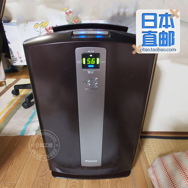

I believe the TCK70 mentioned by bro mik1984 is a Japanese Domestic Model?
MCK70 and TCK70 日本代购 直邮
http://world.taobao.com/item/43214104143.htm?spm=a312a.7700714.0.0.lAR74E#detail

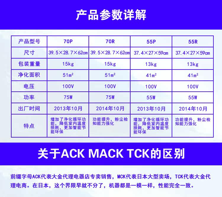

I know what's the difference already.....
The Daikin TCK70P, ACK55 and some others are the JDM models. 100V. Transformers needed here or Dubai.
Dubai and SG (240V) are using the MC70, MC55 etc. Eg the ones you see on gumtree/carousell.com.sg
The Japs, as usual, reserve the best for the JDM or Japanese Domestic Market. So that one is 99% 1 pass.

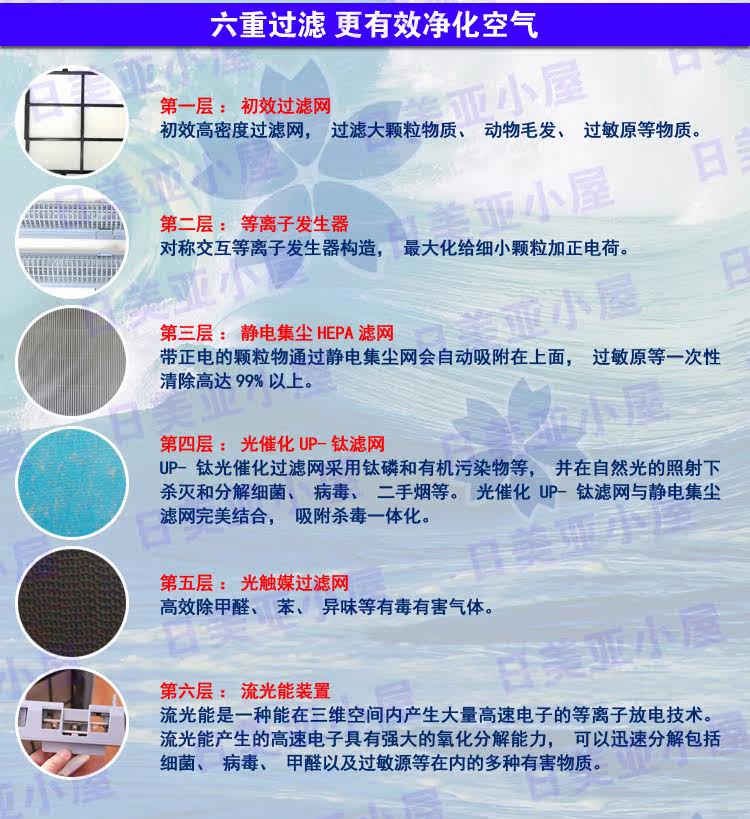

http://world.taobao.com/item/38153224786.htm?spm=a312a.7700714.0.0.lAR74E#detail
The filter is very different, so many more pleats (need that due to more pressure drop)
99% pass mentioned here for the JDM TCK70P, but here it does say electrostatic HEPA already
It says they are all the same, TCK, MACK, ACK

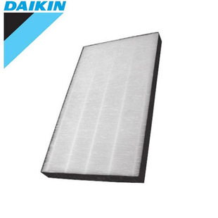

Daikin completely changed this old style filters from 2012 (M,N,P,R and S series) in Japan models, but not worldwide :(
You find specs already :)
semi HEPA filter is rather big
KAFP029A4 398x230x34 218g
http://www.amazon.co.jp/dp/B0075U8E...TF8&colid=3PQOXNWOOG8VG&coliid=I2MQ0234XCU75O
There is a 10 minute video in this seller's listing
http://world.taobao.com/item/430179...805cb382b56a7117&spm=a312a.7700714.0.0.lAR74E

Rephrase you :)
Please check manufacter web site
Yeah I get what you are trying to say already. :)
Their JDM models (like TKP70) are using the new filters which are like the typical HEPA filters that we see with the sidewalls, denser pleating and all. But the worldwide models are still left with the old ones.
