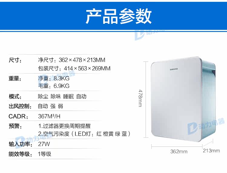

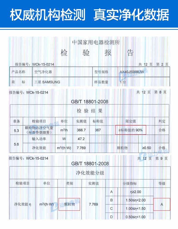

There is a new Samsung AX40 that is 2015 version (Samsung AX40J5006 or 5009 ending with GM or UW). It has 367 m3/hr but power consumption went up a little as well, but not on sale on qoo10 yet.
Currently on sale on TB, but it's expensive.
This bugger even tries to state 27W, but I don't think it's that efficient.
XM2 is 54W @ 388 m3/hr and 31W @ 330 m3/hr.

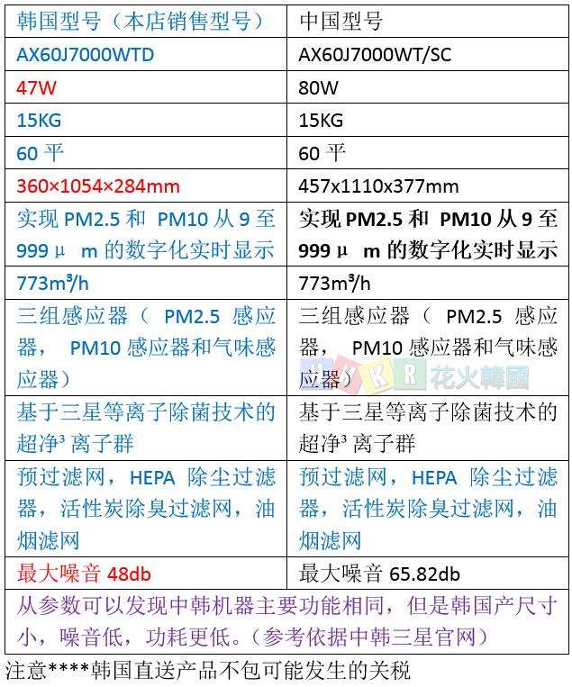

If hands are really itchy and have budget to spare.....just get a Made in SK AX60, or 2. :s13:
