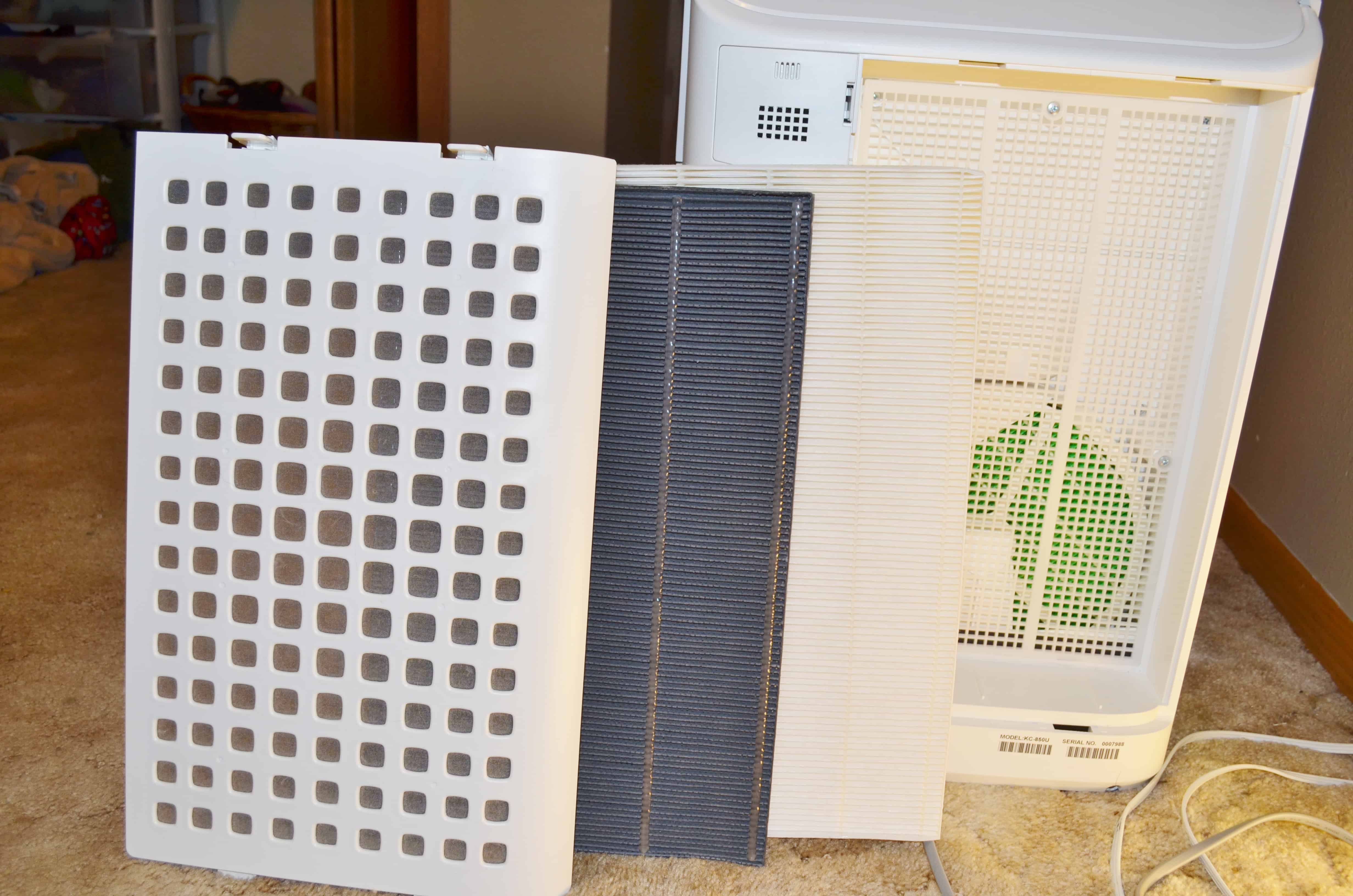

Samsung air purifiers use a 0.5 inch thick honeycomb structured cells to house some AC pellets. The filter for the Samsung AX40 is 11" x 12" in size. It's just a small handful of AC pellets housed in there.
Same thing, the pellets housed in there are not the same as the above Marineland AC meant for aquariums. But they'd still work, I tried before.
The idea is to use enough.
