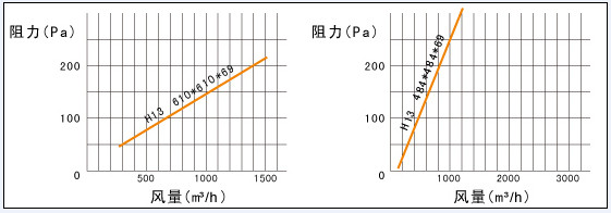

3M Filtrete media expensive leh. You just want to block the bypass so that the air is going through the HEPA media.
There are are a variety of ways to tell.
(1) One very exact and pratically what professional use do is to measure the pressure exerted resistance by the HEPA filter when in use. When it is "blocked" or more correctly termed as useful lifespan reached, it would exert more pressure resistance.
(2) Another exact way is to weigh the filter. There is a specific grams of particulate matter a HEPA can hold. You will find this number as a spec for those cleanroom HEPA filter panels, eg 61cm x 61cm x 50mm panel can hold 60 grams.
(3) For the regular folks like us with home usage, what we can do is to get those anemometer measuring windspeed and do a wind velocity check during Day 1 usage and a few months after that.
Taobao got sell the wind anemometer devices, got few-in-one also termed as portable weather station.
(4) Use your hand to feel and execute some agaration. :crazy:
