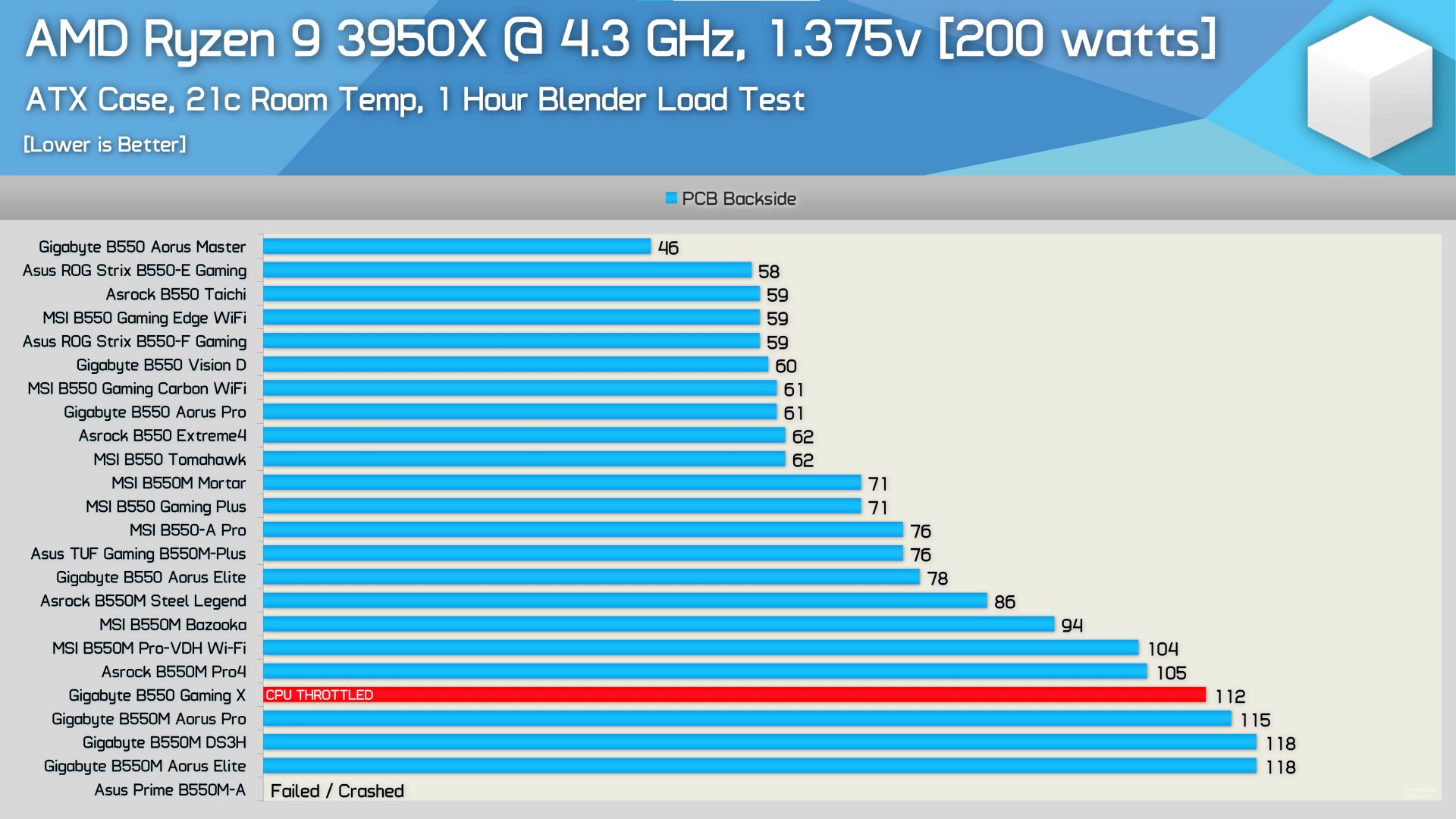

While on the topic of picking B550 MB for high-end AM4 CPUs, let's look into the old stuffs again.
3950x is not 5950x ... 1 hour blender test dont reflect anything.. u know what are u talking or not? I current own quite few 3950x doing mining and I monitor motherboard prices and durability to ensure profitability.. Each time a motherboard die, I need to deduct from my mining profits. Mortar and Tomahawk has the best VRM! No horse run.
know abit, behave like expert.. seriously behkan.
Uh the HUB screenshot says the Gigabyte boards are dogs*it and msi Motar and Tomahawk boards are good, which is exactly what you just said?
I feel I will avoid the absolute low end boards. Most manufacturers tend to cut too much corners just to segregate the low vs mid tier boards. I think the issue may not be limited to just Gigabyte and ASRock. Even Asus Prime can be quite poor in value and work badly.
This is an OC-ed 3950x to test the motherboard VRM capabilities. It still scales to show the board that has the better VRMs.
Huh? Nobody said it is horse run?
:eek: Lol.
I think there is a misunderstanding. @Phen8210 is trying to show the capability/ value of the motherboard build. Just that the review was done with the R9 3950X. Chill man.
LOL.. The bugger recommended Gigabyte board at 130 that can be bought for less then 100. Then current generation for B660 & B690 is dog*it as well.
