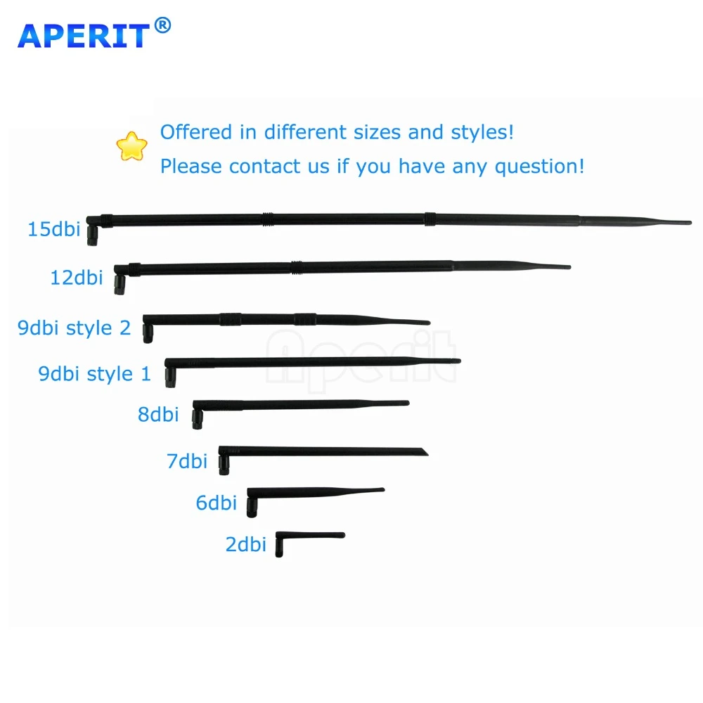

I am still getting lower speed on the iPhone as compared to the iPad after turning off ax mode, while turning on ax increases the speed slightly for the iPhone. Does this mean that the iPad antenna is higher powered?
Larger physical size of iPad means Apple can fit bigger antennas inside the chassis.
For your reference, WiFi router antennas ( bigger dbi number = higher gain )
