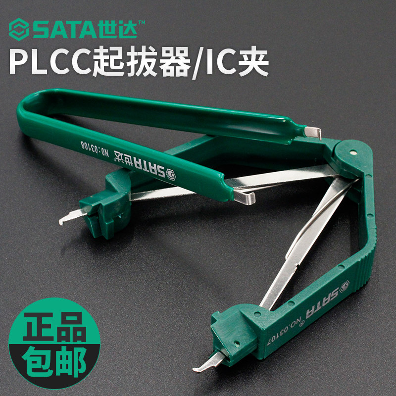

Generally I would advice having this
It should come in a set of standard computer / DIY screwdrivers/tools bag.
You can use hand also, but first timers would likely bend the edgemost pins upon removing. Actually I still do that if I'm not careful. And actually even with the tweezer you can still bend the pins... Key point is to pull up and release the grip on each side slowly.
