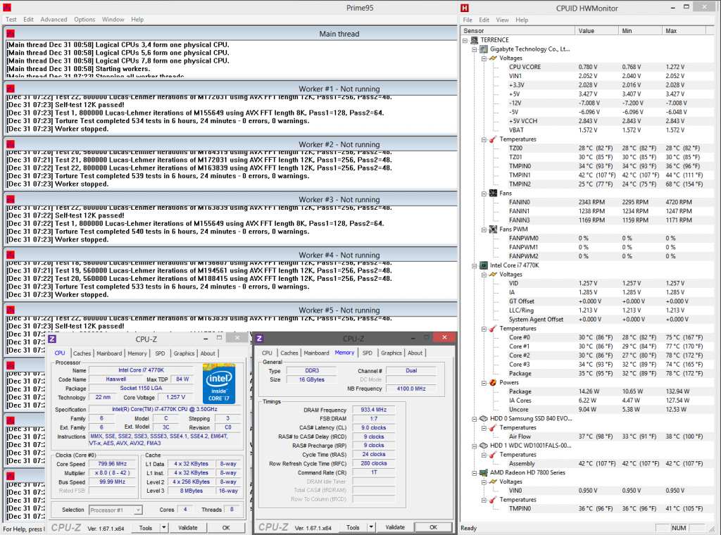

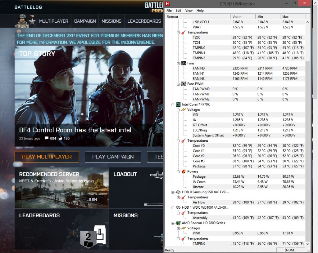

Before Delidding, AVX priming will get my 4770k@4.2ghz 1.25v to 97c peak and a night of bf4 will peak my cpu to 64c
All this with a h100i/gt-ap15 @ 7v with demciflex filter, temp after delidding is extremely even, before its a different of 10~15c between core!
Now this is the picture after delidding!!!:songdah:
