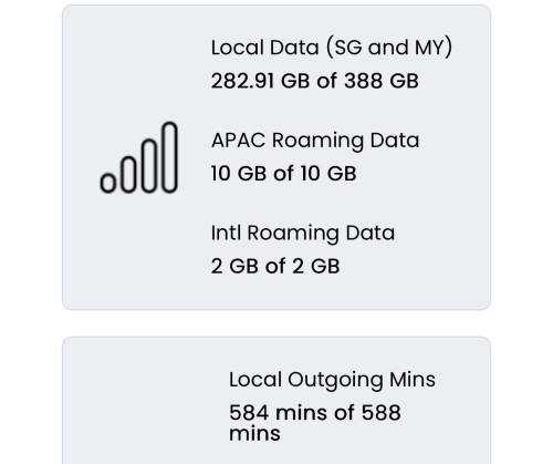

my zero1 still got 10gb left . And Singapore airlines giving 2gb promo for. So total 12gb for 5 days .
I’m thinking whether to buy shoppee $4 for another 10gb 5days or whether anyway to save cost through my current eight second line which is $8

I am currently paying $8. I figure out what one of the member above said , if I were to upgrade to 5g, I may end up be paying more than $19.
shoppee china eSIM for 5 days with 10gb cost $4. I think $12.00 makes more economical sense since I have the eight $8 and just buy a china eSIM which has vpn , and they say quite good according to reviews
