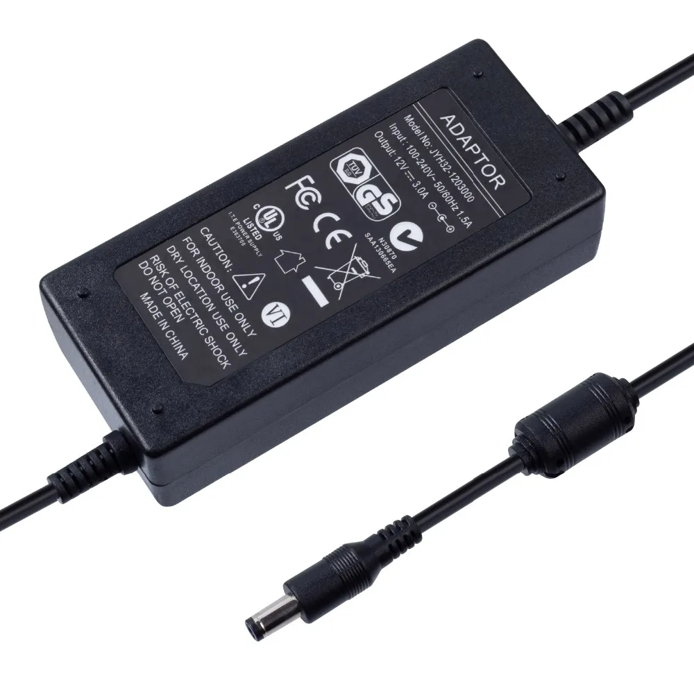

Ok... look at these two adapters, same 12V 3A
This one is 0.5A
This one is 1.5A
Moral of story: Don't think too hard. Trying to explain something you don't understand is dangerous.
