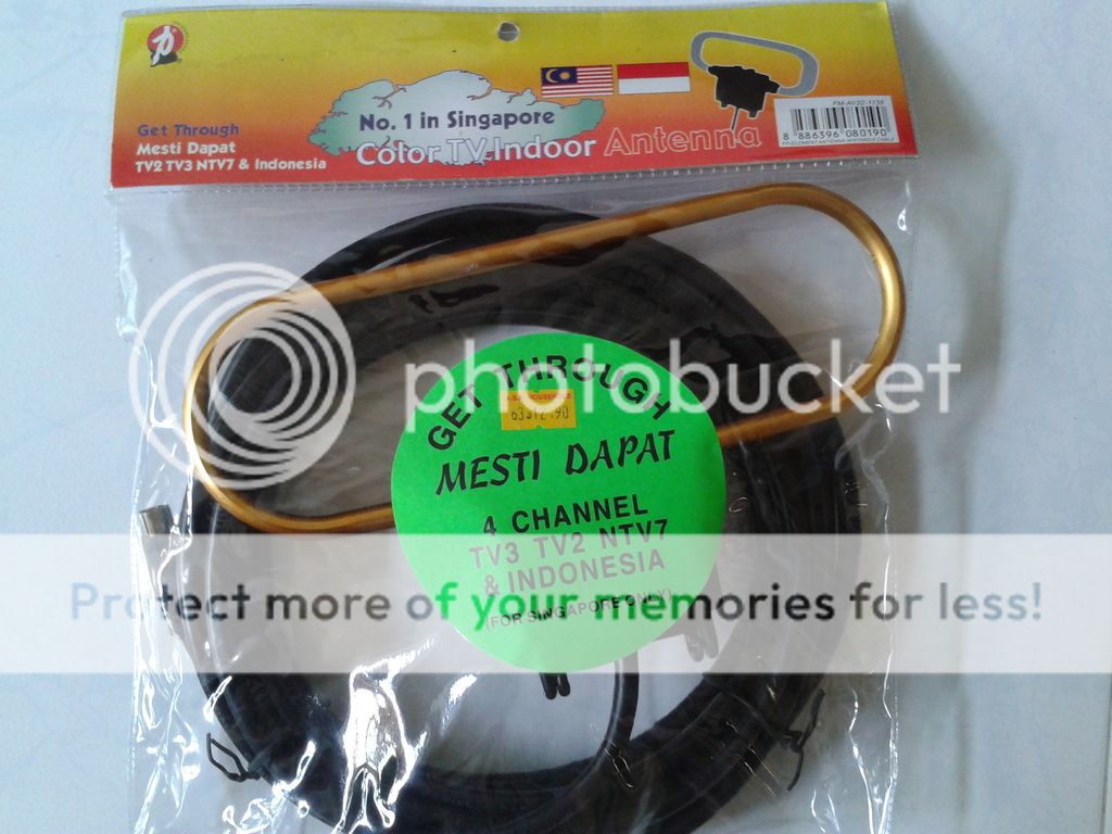

The antenna is the same one we see in pg 2 in this thread. This antenna signal was not acceptable so i exchange with other thing from the store. Thinking that it can't even receive good signal for sd channal don'y even talk about digital signal. Will update if HDB has fixed it.
http://i477.photobucket.com/albums/rr137/suzannejung/01_zps56154e79.jpg~original

That antenna is a very good one actually. How bad did it fail? Did you try every corner/location within your room/house?
I also using the same antenna, and I managed to find only one single spot in my living room where I get good quality and signal for all the channels I can receive
I am on the ground floor and my building is surrounded by trees and tall building.When connected to crt tv , the image is not possible to see alot dots and lines. I try to move around but due to the length of the cable, i was bound to living room only.
pg2 is not a good reference point. If I am logged on, it would be on pg4. Had you say post #20, then it would be better. Still, there are 4 indoor antennae mentioned in that post, that's why I asked for the specific model so that I can tailor-make my advice according to the antenna you bought (there would be different instructions for rabbit ear antennae).
There are certain information which you are not aware of. Indoor antennae can receive both analogue signals and digital signals. For good analogue reception the signal has to be strong and free from reflection (ghosting). There can never be good indoor analogue signal unless you are on high floor and have clear view of the transmitter. As mentioned by you, you are on ground floor and surrounded by trees and tall buildings. You have no chance of receiving good analogue tv signal with indoor antenna.
On the other hand, digital signals, which can be HD or SD, need not be very strong compared to the analogue equivalent. Furthermor, digital signal is inherently robust and is designed to eliminate ghosting even if it exists. There is a high chance to get digital reception especially since you have a long cable to play around with the location.
You should have tested the indoor antenna with your new tv to see whether digital reception is possible.
Anyway, just keep your fingers crossed and wait for HDB to change the matv point. You can then test for digital reception with your new tv using the matv point. Do keep us posted on the outcome.
