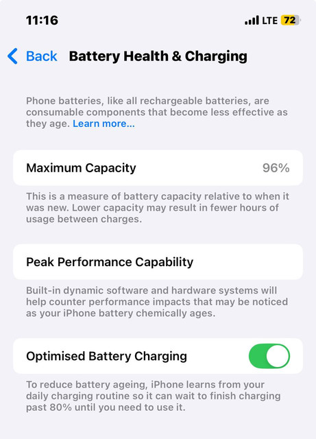

Recently, I repaired the 2x iPhone 12 and 1x iPhone 12 mini battery myself with original Apple batteries.
First, I sourced the Apple Original batteries on 闲鱼淘宝 (2nd Hand Taobao). They do sell brand new authentic batteries (Apple sealed) and second hand but original batteries. For the price point, I chose second hand original battery between 96-99% for S$15/RMB65. They do provide DIY tool kits for the repair as well.
Secondly, when the spare parts arrive in Singapore, I went Youtube to learn how to repair. They have many tutorial guide to teach you what to do. Overall, I rate the repair easy.

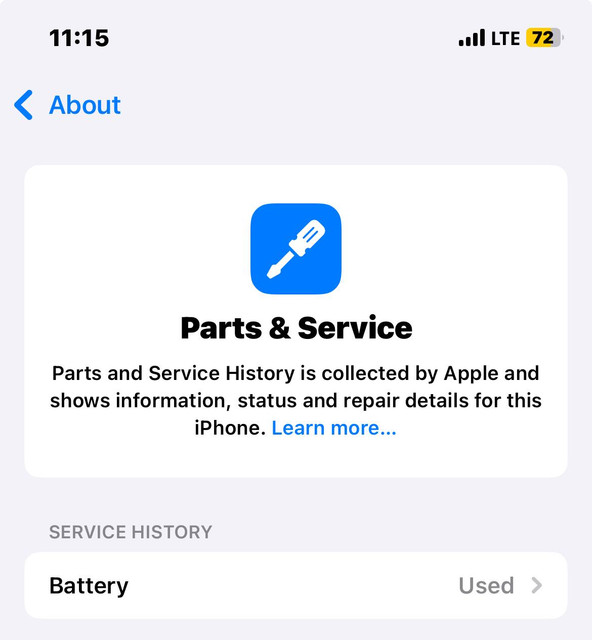

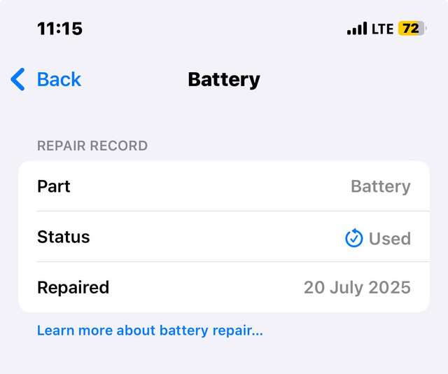

Thirdly, original Apple batteries (including used) allows you to run Apple post repair diagnostic to pair the battery to your device. Note that third party batteries do not have this capability.
Lastly, after repairing and running post repair diagnostic, Apple will certify it is authentic and have this repair history reflected on your device:
$15 used but original DIY vs $128 new and original Apple Store repair - I'd choose $15 DIY repair for the price point. Note that $15 is used iPhone 12 battery. For newer model, 咸鱼淘宝 sells it more expensive (e.g. iPhone 13 99% BH at $20-25 etc)

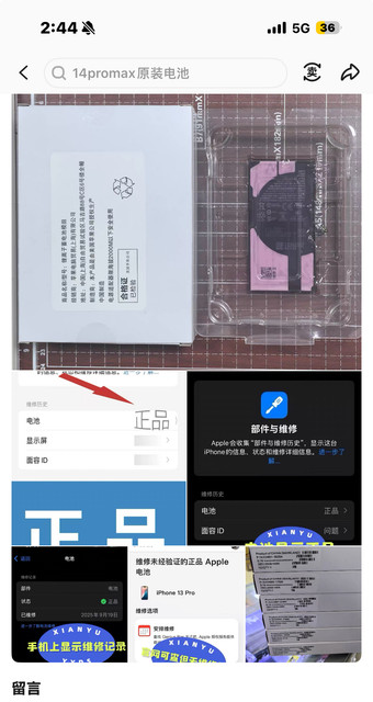

Example of Brand New Apple Original iPhone 13 battery selling on Xianyu Taobao for S$32:

Best damn news I’d heard in awhile.
If only they release official waterproof adhesive for self-repair as well, I’d do my iPhone 12 too.
My understanding though is that when you replace your battery with Apple it doesn’t reflect as Repair Record … I won’t know if your case is because you are using used battery then it shows up, or is because they changed it so as long as replaced even brand new will show in the Repair Record.

If Apple does a Whole Unit Replacement, there will be no repair record reflecting under Settings > General > About.
I did a battery replacement under Apple Limited Warranty for my current iPhone 15 Pro at the Apple Store last year and it did reflect under the Repair Record.

Oh okay … so it will show but show as “Genuine”, but if not a brand new part it will show as “Used” like in your case instead.
