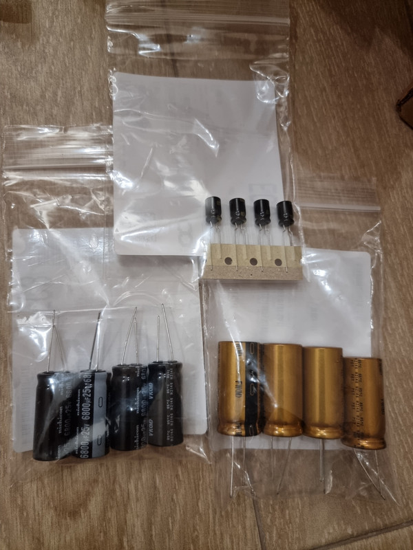

The capacitors being replaced and their replacement.
The poor quality of the printing on the Chinese capacitors is an indication of the poor quality of the inside. If you buy branded capacitors like Elna and Nichicon and etc from China and they have shyt printing like that they are most likely fake.
Recapped. Looks much nicer now.
Hi again, may I know where u get those caps? If I personally go to simlim tower I would be able to find them? Or there is an online source? Looks like my caps are bloated..
wwenze
Dec 2, 2002
87,097
30,660
I prefer to use websites like element14, Mouser and RS-Online. Check which one is currently having free shipping because their shipping policy changes all the time.
Websites are best because you can find the specific capacitor with the specific pitch / OD / etc / quality you want, which is difficult to achieve with SLT shops. When I went to SLT shops because I needed it fast, I had to settle for a brandless capacitor.
F@|c0n
Jan 20, 2013
353
Bought 2 x of everything from Mouser. Since they charge 25 sgd for deliver, when i ordered double, its free delivery :p for the same cost

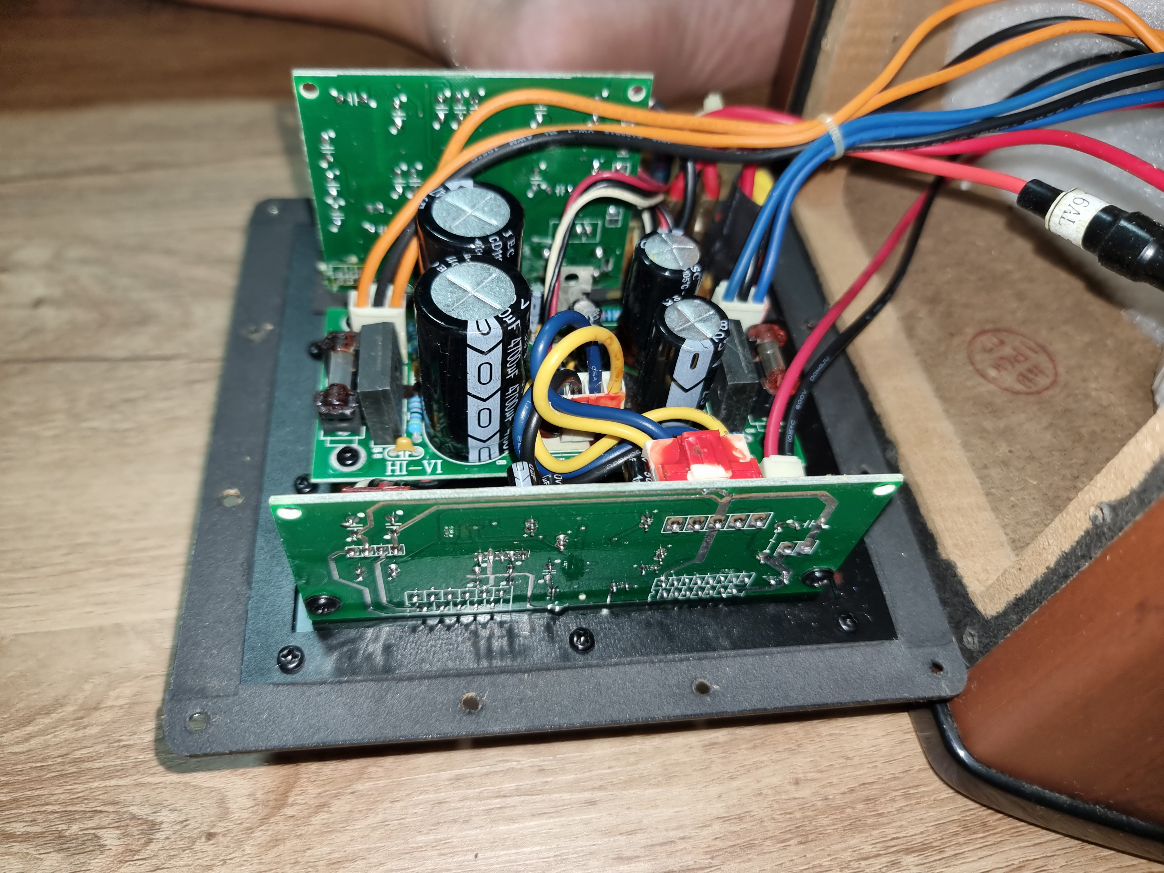

Hey wwenze sorry for bumping an old thread. My Swan M50W speakers just started acting up today. There’s a sudden, very loud humming/buzzing sound coming from them.
Audio still plays through, but even when I turn the volume all the way down using the control knob or turning it off, the loud buzz persists. Even with all the satellite speakers unplugged, the subwoofer itself keeps buzzing. Based on previous posts here, is it safe to assume the capacitors are dead? Any advice is appreciated!
