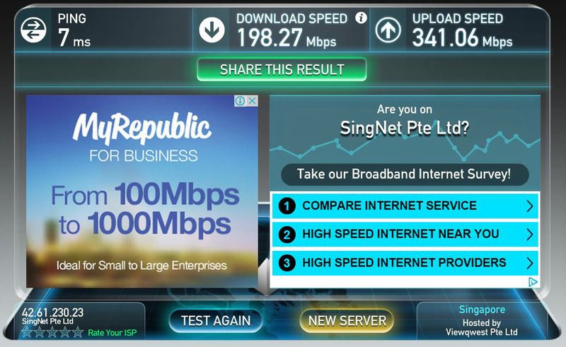

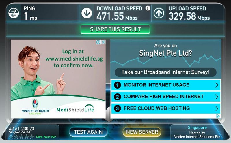

Hi ASUS@SG (JK) and Anyone - appreciate if you could help.
I purchase the pair of RT-AC87 and EA-AC87 after rave reviews. And I still want to believe it can work for me.
I have Singtel 500mbps fibre. I use RT-AC87 to replace the Singtel Aztech 7003. In the next room, I use the EA-AC87(media bridge mode) connected to my PC. Reason: pulling cable is out of the question, and I want the best possible throughput for the setup.
When I first set it up - the first few wireless speedtests were very very encouraging:
I got very very close to wired results.
However, subsequent PC boots in the next few days... the wireless bandwidth will drop and I will get this:
Unless I reset everything and power cycle everything from scratch again.
If there is anything anyone can suggest - I'm all ears. Thanks! :)
(both using the latest official Asus firmware)
Jordan
Kway
191
Each time the devices are reboot. It will auto detect the best wifi channels thus you get the best connection. Over time, the same channel get congested and connection might not be as optimal as before.
