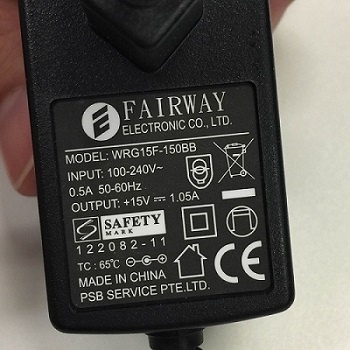

AC Power Adapter Needs Safety Label
This is for consumer awareness.
Power adapters belong to the 45 categories of Controlled Goods under the Consumer Protection (Safety Requirements) Registration Scheme, and are required to carry the SAFETY Mark.
An example is shown below:
Quote from Spring Singapore
"Do not buy Controlled Goods without the SAFETY Mark
It may be tempting to pick up that new gadget on sale overseas, or that really cheap AC adaptor from a popular online marketplace. Without the assurance of the SAFETY Mark, you and your family could face undesirable scenarios like the following –
An AC adaptor could overheat and melt, posing fire and electric shock hazards
For further reading, refer to the source:
https://www.spring.gov.sg/Building-...uments/SAFETY_Mark_ACCURACY_Label_and_You.pdf

mrsun18
May 30, 2011
2,916
23
Spring certification and quality issues are different matters, although some aspects are similar (same same but different, haha)
Just an analogy. A barrel of apples are sent for certification. Some are picked at random. If they pass the tests, the whole lot are released for sale. Some unlucky buyers get the bad ones.
Quality products cost money.
