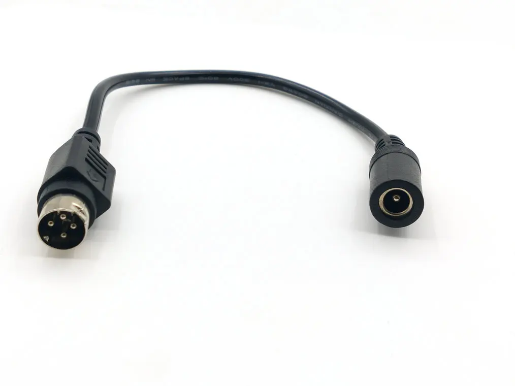

Much neater and easier to use this 2 combo. left side 1 pc Male (green colour) connect to below "DC Female 5.5*2.1mm to male 4 Pin Cable Lead"
eauyong
Jul 29, 2000
2,053
144
If adaptor comes with this Male DC Connector 2.1*5.5mm, then just get the 1pc DC Female 5.5*2.1mm to male 4 Pin Cable Lead
i1magic
Dec 11, 2002
22,365
117
This one cannot. The polarity is wrong.
Need polarity like this one then can.
