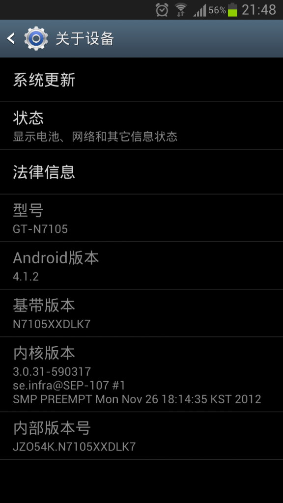

there's a new firmware for south africa N7105XXDLK7.
Carrying 4.1.2, haven't try on my set yet. not sure gonna try first or wait for local ones.
this 1 no chinese lang right ? if yes i wud like to try it. :o
