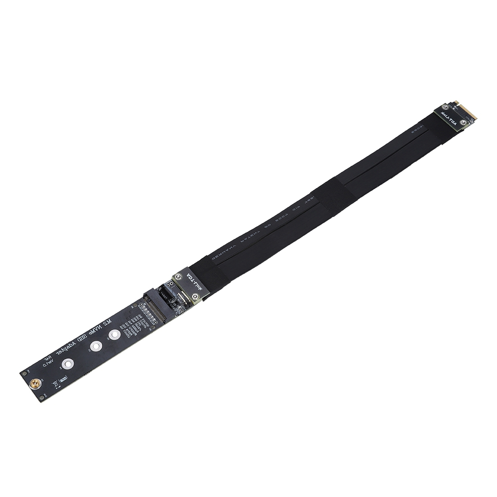

Any folks thought or use nvme ssd extension cable and mount the nvme ssd to somewhere for better space and cooling ? Share some pictures with everyone. :)

Since no folks here has moved their nvme ssd to other location for better space and cooling.
I share a useful product with pictures of mounting nvme ssd to drive bay. Someone like me would be glad about such finding. :)
