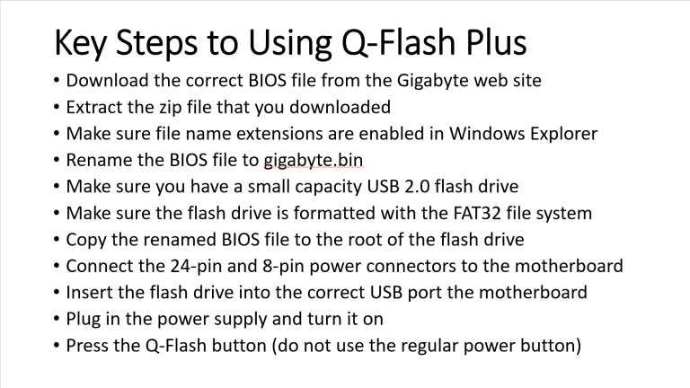

Hi, @Jurchen King , i just took a look at my B550M-DS3H
you can perform a Bios Flash via USB (Q-Flash Plus) ( the white usb port near the Rear audio jacks)
Credit goes to glennsqlperformance.com for the image
the Q flash button is located on the board itself and not the rear IO
maybe worth a short, if you think it is a board issue, before u send for RMA)
