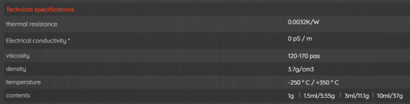

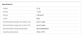

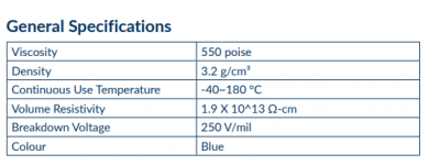

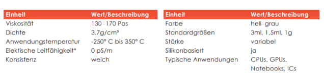

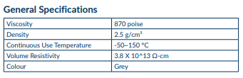

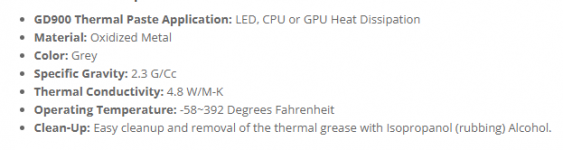

As I recently bought the Cooler Master Cryofuze thermal paste and apply to my new EK 360 Basic AIO noticed its good cooling performance (spoiler with screenshot normal operating non gaming), I started to get interested in the thermal paste specification and below are some of the popular thermal paste comparison for quick reference:
Cooler Master Cryofuze: maintaining stability from -50°C up to 250°C.
Arctic MX-5: maintaining stability from -40°C up to 180°C.
Arctic MX-4: maintaining stability from -50°C up to 150°C.
GD900: maintaining stability from -58°C up to 392°C.
Noctua NT-H1: maintaining stability from -50°C up to 110°C.
Thermal Grizzly Kryonaut: maintaining stability from -250°C up to 350°C.
