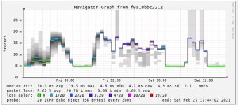

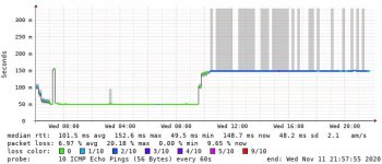

It might not be noticeable for short calls, but a drop out is definitely noticeable when your meetings (cos class) are 4h long. I had 3 memorable moments of call drop outs during 3h class (and this particular lecturer came on 45m early and stayed for 30m after to entertain questions), and a Smokeping log from a friend who happened to be monitoring Singnet during that period suggested dropped packets.
Second and third were via a wired connection direct to the switch in the hall, cos I was tired of seeing laggy lecturers and classmates.
Edit: Went through my screenshots of Smokeping graphs to the same local servers on a Singnet connection. This was on my previous ERL3 so no IDS/IPS running. SP is running on my ARM SBC via an Ethernet connection - dates and times as indicated. Make of it what you will.
My friend's.
My own connection.
