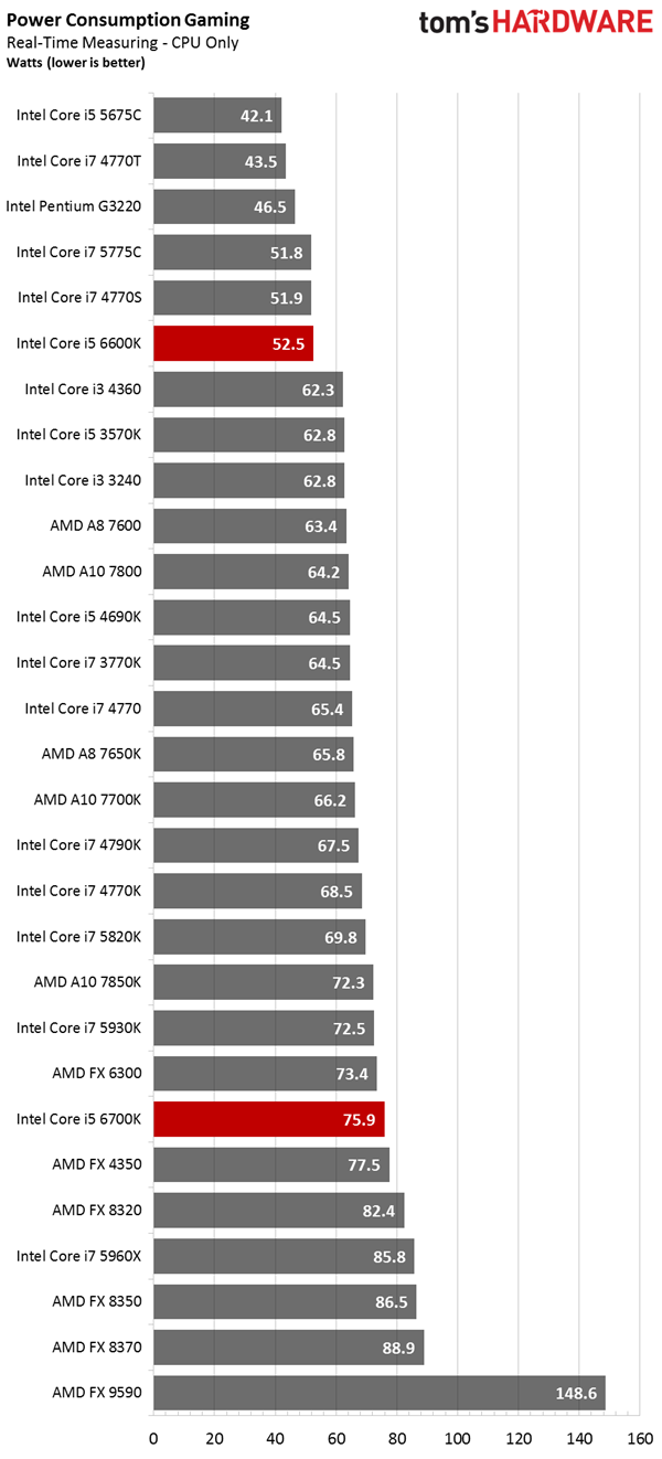

Skylake i5 draws just 50W when gaming. That's even less than a 5600G.
https://cdn.mos.cms.futurecdn.net/u3nK3KNMiWBMWpgqJF943Z-970-80.png
Yup, heat in the Skylake system wasn't a problem and there wasn't a backplate problem like this one because of the stock cooler so it's all good.
