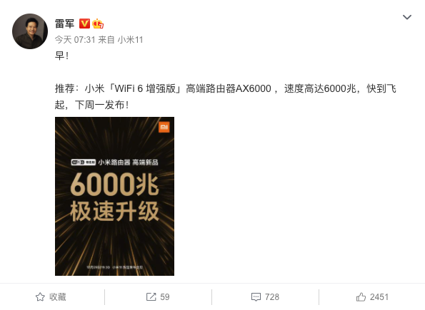

Xiaomi AX6000 is coming. Not so sure if it is really Wifi 6E, probably not, just saying it is faster than the current AX3600.
https://www.igeekphone.com/xiaomi-ax6000-high-end-router-will-release-as-first-wifi-6-enhancement/
My bet is on a similar qualcomm designed like asus RT-AX89X
so in essense:
1) IPQ8074A
2) 2 X QCN5054 5GHz (8x8 80MHz or 4x4 160MHz) - 8streams
3) 1 X QCN5024 4x4 2.4GHz - 4steams
4) potential for multiple 10Gbe ethernet phy.
so compared to ax3600
1) faster cpu 2.4GHz vs 1GHz(1.4GHz overclocked)
2) 8x8 vs 4x4 on 80MHz, 4x4 vs 2x2 on 160MHz
3) full on 4x4 (2 additional FEs) on 2.4GHz vs 2x2 (IPQ8071A only supports 6 streams total)
Downside:
1) heat will be a major challenge (may use fan, no no for me or use a massive heat sink)
Personally, if as a standalone AP, don't think it offers any real benefits. 8x8?? may as well by 2 units of 4x4. Also mu-mimo and OFDMA is still flaky and support is inconsistent on client devices.
However as a part of a mesh system with ax3600 wireless mesh nodes and ax6000 as the mesh router, it will be an interesting solution. Qualcomm has much better mesh implementation than Broadcom per say.And if Ax6000 is priced under 800rmb, asus should be shitting in their pants... lol
If it is priced under RMB 800, I guess that many of us will buy the new Xiaomi AX6000.
On the other hand, I think this one will be priced higher, probably matching TP-Link XDR6060 (AX6000) at RMB999, which is still a pretty good buy.
