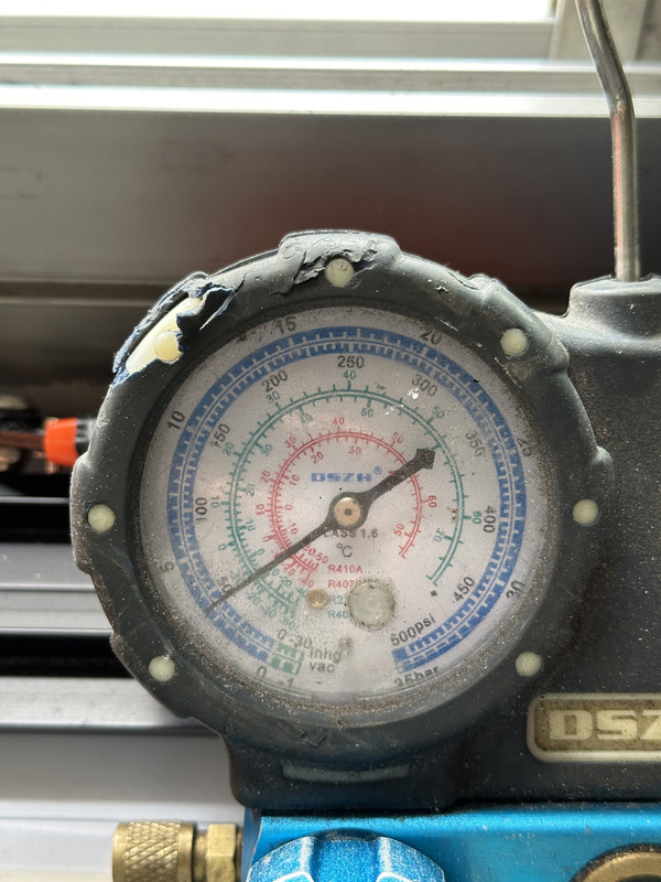

Update:
service man came today. Gauge show low gas pressure. Tested all joints but no sign of leakage.
150 pressure is standard, for R32 not sure can reached at 150 or not.
My 28VG pressure reached at 140 max.

Update:
No gas leak, but low gas pressure.
The only explanation will be it was low gas pressure all along since installation only took place 1 month ago. Either way sounds sketchy.
Because it can only be one of 2 things, either they didn't set the gas pressure during installation (unlikely) or there is a leak, but they are unable to identify.
Did you see them spraying soapy water at joints or connection to do the checks? How did they check the pipes to confirm that there is no leakages?
They did spray soapy water at the condenser joints and joints at the fan coil.

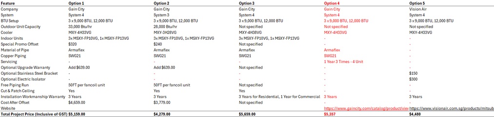

johntan93
Nov 27, 2015
52
Thank you for the detailed clarification on the air conditioning setup. I do have a few follow-up questions to ensure I fully understand and make the best decision:
  1. I'm not an expert in air conditioning – for the setup you're suggesting, do I specifically need to request 2 FCUs per condenser - not sure if the default setup usually includes just 1 FCU per condenser
  2. Regarding the 4H38VG compressor model you mentioned, should I confirm with Gain City that this is an available option for my needs?
  3. You mentioned, "When you run the system 3 other FCU at night and only 1 FCU, the low maintenance power will be higher than a System 2 condenser." Given my scenario, where it's unlikely I'll turn on both the living room and study room aircons at the same time, could you clarify if focusing on either the master bedroom and two other rooms (first compressor) and the study room (second compressor) will result in higher electricity costs compared to a System 2 setup?
I'm leaning towards going with two System 3 setups from Gain City but wondering whether the quotation makes sense.
Update: To make things simpler for anyone looking to compare different aircon setups, here’s a handy table that you can use when comparing details like models, BTUs, pipe material, and copper pipe specs. Had a hard time deciding between Coolserve and Gain City but we're leaning towards Option 4 (Gain City) since the parents are keen on avoiding any wall hacking and Gain City has terrific afterservice.
I think more important is, whether the CU and FCU can meet the needs first more important....
I saw my neighbours 6 FCU, split them to 4 (4H38VG) plus 2 (3H28VG). End up they pay more but not enough cooling for the living and dining.
