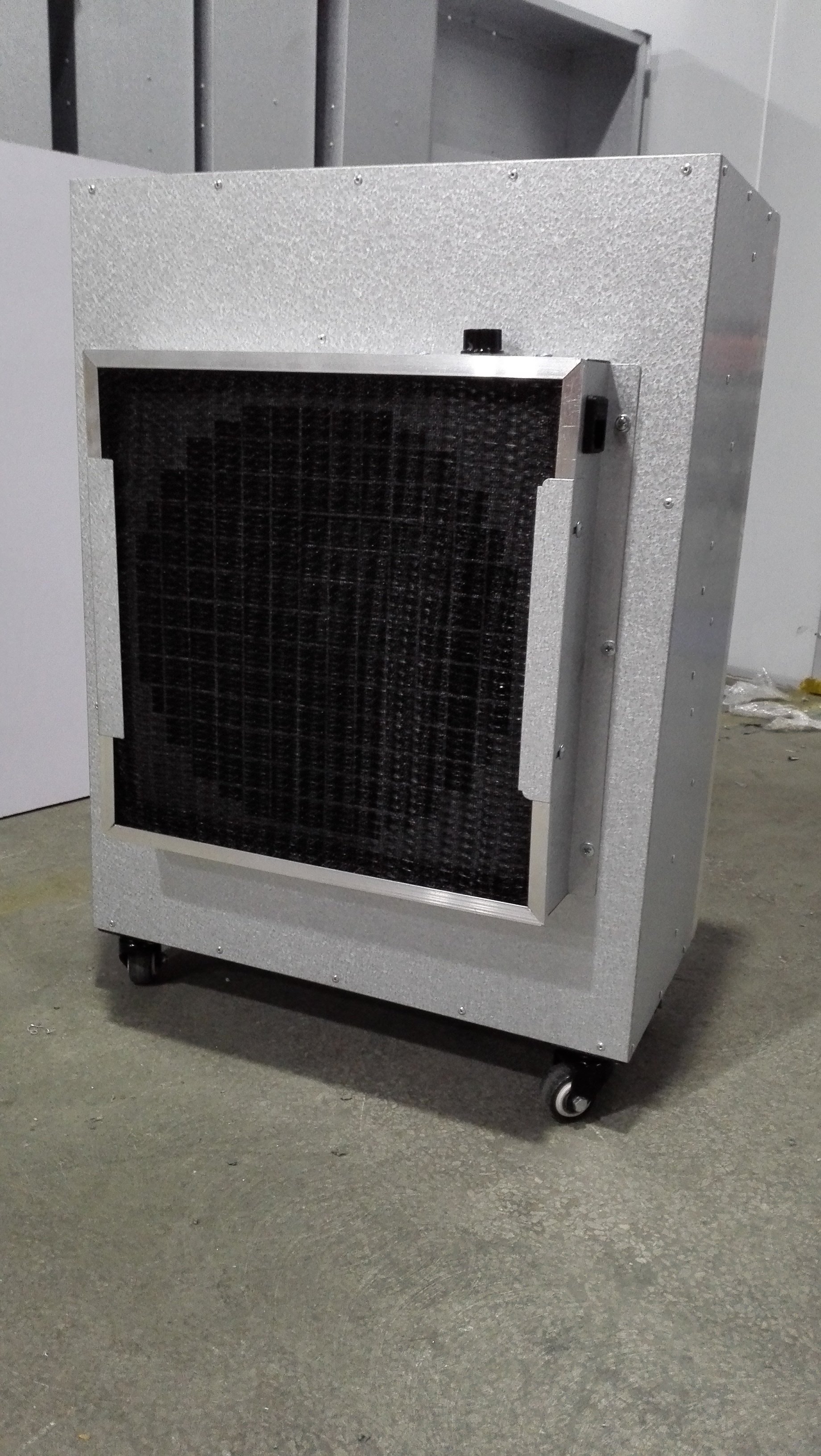

Also featuring the Cleanroom FFU/Fan Filter Unit. Is big-ass unit, no doubt. 1200 m3/hr, but really low in sound pressure level. If you have space for it, might be good, eg for mansionette, those 140+ m3 5-room units, landed etc.
1 unit clean the whole house, doors all opened, have individual fans inside the rooms to ensure a bit of airflow.
2015 haze experience, can do one, no issue....some of you folks would know the drill.

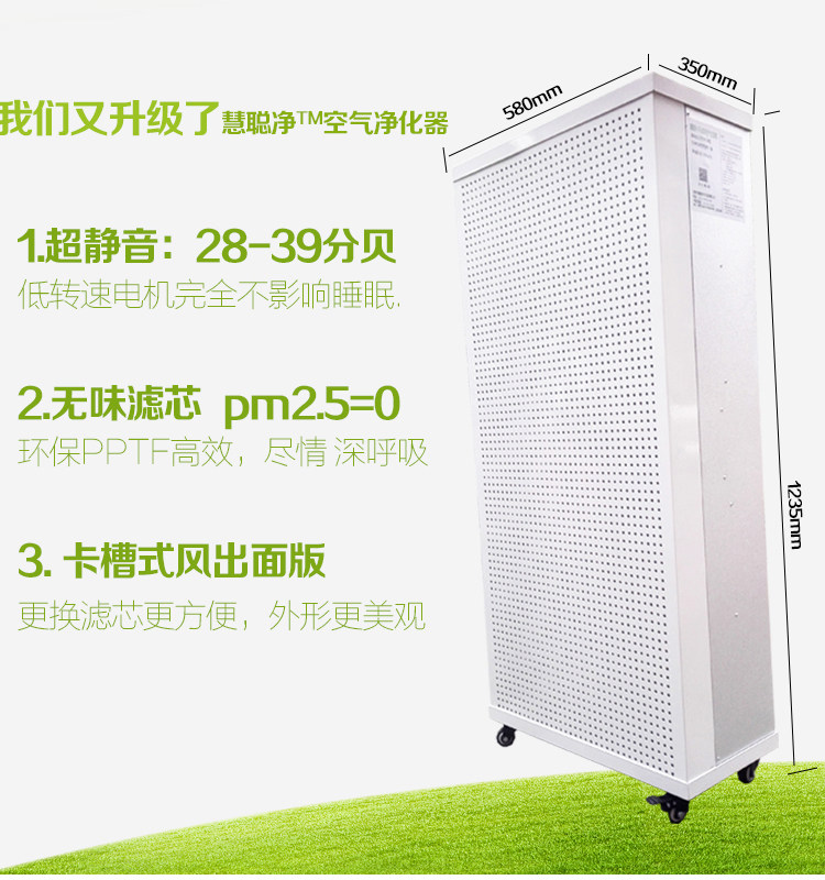

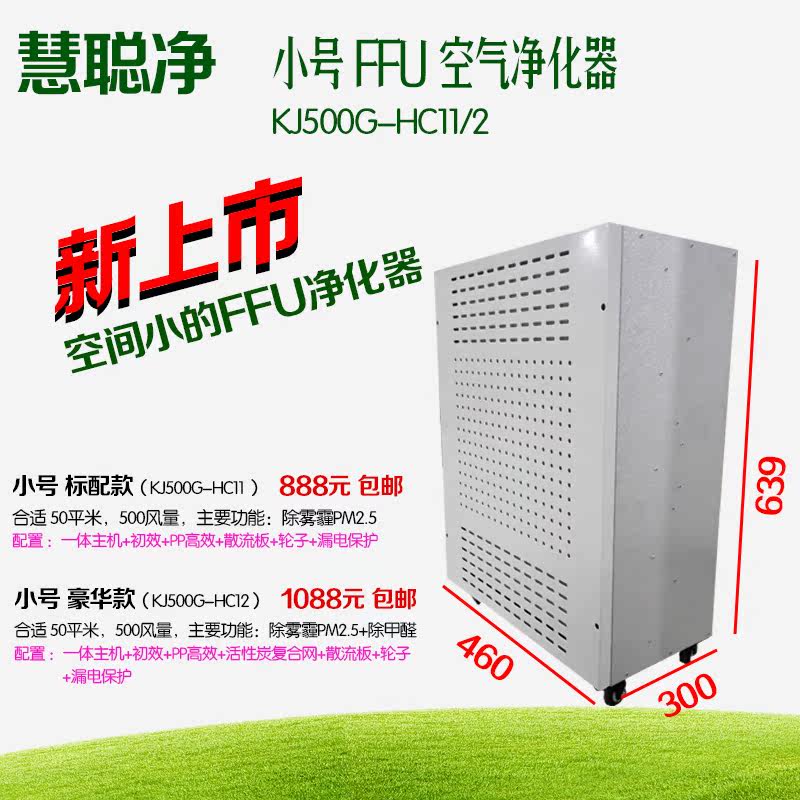

They also have the half sized ones. ie Instead of 1.2m height, it's 60cm height.
In a way, the filter cost and ease of shipping is also improved. Can even use official forwarders as it'd be below the length restrictions, ie 4PX max is 120cm, might be cutting it a bit close coz it does come with cardboard boxes....though Prouter is 1.5m iirc.
See if you wanna sea ship or you can spend the dough to air ship. It's approx 30kg with the shipping box for this bugger.
The good thing is that you would be able to utilise the whole 500 m3/hr airflow.
It would even be less noisy than the above full sized 1.17m tall version. (ie 3dB less, basically a half cut of it )
Everything in, still cheaper than the Sharp A80, Sharp A50, Novitas, Philips etc...... 888 RMB price for china domestic to your forwarder's warehouse, but i suppose better prepare for 950 rmb to upgrade to 顺丰.
Front view still sucks though. :crazy:
Replacement filter @ RMB 160 cost only. (SGD 32)
Don't worry about particulate/filter life capacity, this one can hold like 5X the amount of our branded HEPA filters. 1-2 years change once is definitely doable.

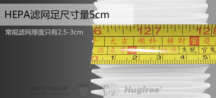

The product is this "naked" HEPA filtration media. Don't wanna bore you with the details, but trust the few of us it'd work ok and we have verified with laser particle counters. Don't worry with whatever filter leakage as it's pretty minimal, it doesn't really matter much in our real life unless if it's a lot, but in a cleanroom that'd matter of coz.
https://item.taobao.com/item.htm?sp...296&pvid=43635d5f-f000-4b2b-bae2-00fb48e1c353
What you need to do is to use a penknife or sharp scissors and slice off about 2cm worth of it, it's very easy....just a 2 min job here at most.
And after that use the bubble wrap or plastic bag that came with it, roll it up and squeeze in to plug the gap. Picture illustration below.

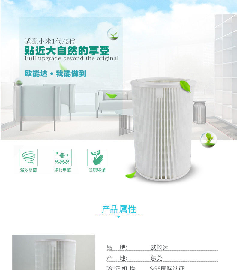

Had some time to go into details the above RMB 50 Xiaomi AP 2 filter. Seems like it does not have a pre-filter built-in..... plus it is about 1-2mm shorter than original (just use some paper to slot under the filter in AP to provide a good seal, no biggie).

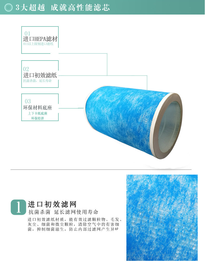

This one RMB 53. Has a pre-filter built-in so that you can filter in every month or so.
Seriously speaking, this blue synthetic pre-filter layer is about G1-G2 efficiency and is sufficient to capture most of your dust and lint floating around when things are disturbed. It's probably a wee bit better than that plastic netting pre-filter that you see in aircons and other air purifiers.
Will it work? Read the reviews... even between 3rd party filters, there might be differences. So read the reviews and test it out before embarking on bigger purchases and stocking up for future.
