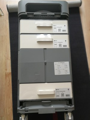

IQAir GC Multigas. Filter replacement is gonna be very painful though, even if it's a 2 year thingy or something like that. Unless if one is fooking rich. :s13:
The 352 X83 Plus. Filter replacement rmb 999. Decent.
Xiaomi 2S is also nice if you really cannot afford the big units. You get multiple units and shift them around if necessary. There are 2 filters, 1 normal, 1 is for formaldehyde, 1 is simi anti-bacteria.
Get the Formaldehyde version, it'd handle most of the VOCs listed above, and also many others.
ps. proper units as in units that have a high Formaldehyde gas CADR rating. If it's just for indon haze, any air purifier would do and is decent, as long as value for money, and doesnt make too loud a noise at a certain airflow m3/hr setting (usually medium is nice).
