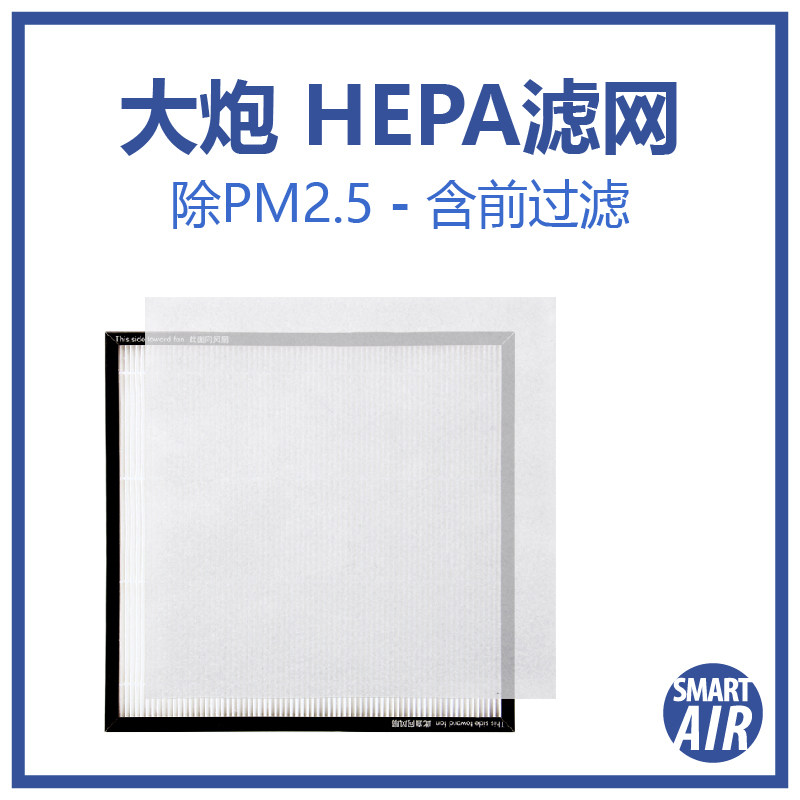

There is an anna642 store on TB, the HEPA media that they are using is a bit different.
It gives quite a significantly higher airflow as the media has lower resistance. And even at lower resistance, on my laser particle counter, i could measure an even lower particle count. ie its CADR is higher.
I have used one pc before, literally no smell at or, as in you "air" it for 1-2 hrs and it's usable.
It's by Smart Air, that DIY Cannon filter thing operated by the Ang moh, i suspect the wife or sister or what is doing the sales or something.
https://item.taobao.com/item.htm?spm=2013.1.0.0.676c6db4rjDpgo&id=36957624459

Just changed new filter I bought since few years ago.
For Samsung AX40
But it reduced the airflow & also producing some plasticky smell since last night...
Will tio plastic poisoning in the end? :( I have kids at home... sigh...
Changing from the orignal AX40s to the TB ones, at least for the 300x300x25mm (then you cut one side up and stuff the other side up with plastic wrapping to reduce airflow) would make it an approx 220 m3/hr CADR machine from my calculations.
Original is around 320 m3/hr CADR.
That's still mighty fine for a BTO bedroom.
And more than sufficient ACH (at least 5X) for filtering allergens like dust mite droppings or mold spores that gets circulated by the AC FCU etc.
ie no issue for sensitive individuals.

TLDR all the dry data and stuff like that -
1. Use the TB filters with confidence. You cannot get any lower cost + more cost effective solution than this. Esp if your AP is purchased from Carousell and DIY cleaned and sanitised with alcohol (I have 2 additional AX40s bought at just 50 bucks 60 bucks lol!)
2. For the smell issue, air the filter in your AP in low speed mode for 48 hours prior to usage. If you have use for it at night, maybe change it back to the ex/original filter, before continuing the next morning.
3. It is especially good for those who want to spend the least amount of money for max performance. And also for the lower income groups. Lower income groups also have lungs and they should have access to good clean air as well.
