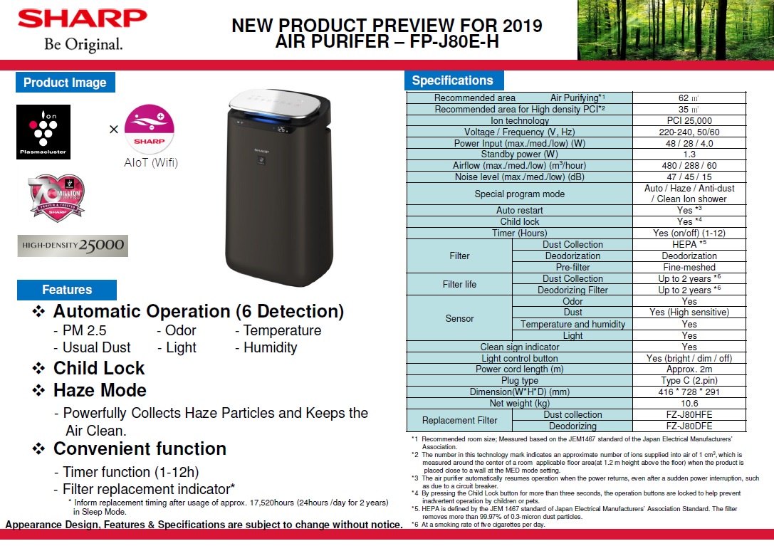

Any comments on this AP?

am also considering the plasmacluster
but for this i can get the Dyson TP06 Cryptomic which is better looking. haha
