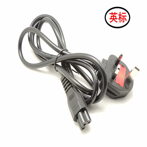

so its just a matter of taking out the existing cable and plug in the BS1363? the same cable we power up monitors and desktops?
i ordered for the IEC styled, 3-pin BS1363 cables from Taobao too. 1.5m long each, Mickey-mouse output. best not to use travel adapter for regular usage.

Yep....i koped one mickey mouse from my coy's old notebooks.
Using this for my Mfresh M8088A. Going to get one more.
Wasted, last week got one 4PX shipment. Nvm...added to cart.
https://world.taobao.com/search/sea...=_AB-LR517-LR854-LR895-PR517-PR854-PV895_2462

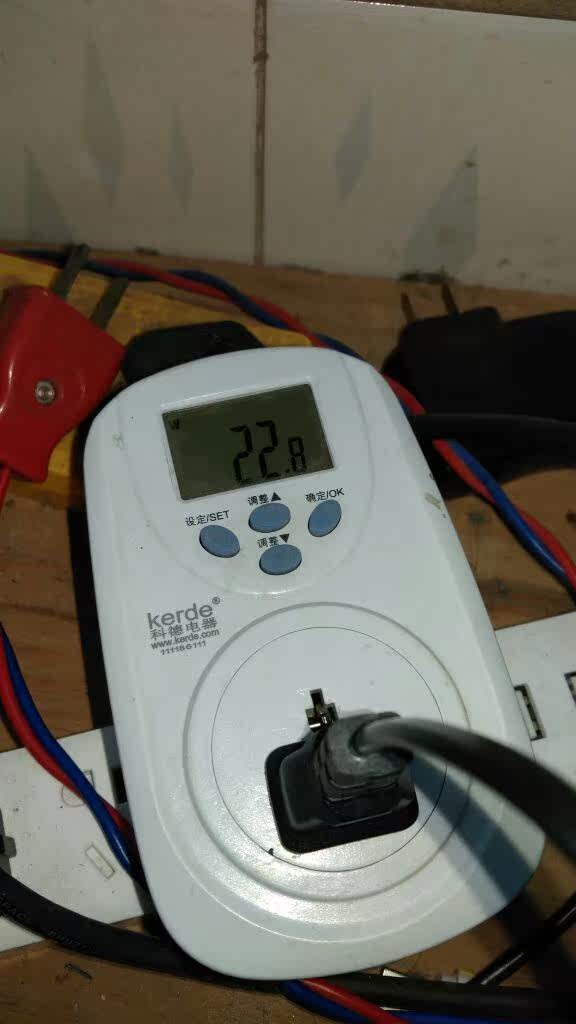

I have the Midea KJ30FR-NV3 so i am very familiar with the sound levels. Note that the second fan speed (49.8dB) is already noticeably louder than the AX40 in HIGH fan speed.
So you all make the decision
http://www.pcpop.com/doc/1/1240/1240565.shtml
Power consumption is 54W in 388 m3/hr jet mode.
  单电机对于功耗的降低也是十分有帮助的,在睡眠模式下,小米空气净化器2的功率只有1.7W,Turbo超强模式下也只有54W,比起一代的4.2W和82.1W都有了很大的进步。按照每日最低档10小时最高档1小时计算使用成本,小米空气净化器2一个月的耗电量为1.63度电,很省了。
小米空气净化器2
Turbo超强模式:63.5dB     标准模式最高档:58.2dB     睡眠模式:35dB
小米空气净化器
最高档:70dB     睡眠模式:35dB

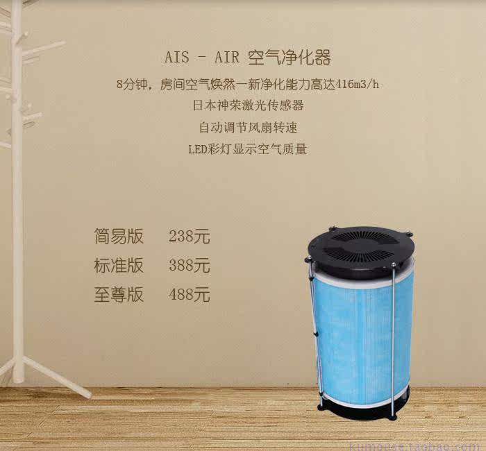

For those who wants to beef up their living room stuff.
Just chuck it into the corner and out of sight out of mind.
RMB238, manual 1-touch 3 modes fan speed control. Low, Medium, High.
Hope the spacing between med and high is ok.
Dafug, DIY can do it correctly vs Xiaomi and Samsung. !@#!@#^$%#%
This one would be loud, don't expect too much. But hey, the RMB699 and RMB899 options are loud as well. So no real loss. :D
Don't expect this one to work well in the bedroom also as a DAILY USER, though i really don't know how it does and measures in real life.
Decent SPLs would mean AX40, but hey you gotta pay for it + the $$ filters. That means 2 units for the living room.
The packaged filter in the RMB 238 package would probably be H10-H11 grade, be prepared to get that. But then after that you can order the original XM filters. But i measured others before with the laser particle counters, pretty ok lah.
Handys quite itchy to try, unfortunately this year no haze risk. :(
Fan is NMB, so is well-known branded.
https://world.taobao.com/item/527177820189.htm?spm=a312a.7700714.0.0.bcAsxH#detail
23 watts full power. Suspect airflow won't be that high.
But it is a very small unit.
correct for part 1, wrong for part 2.... the IEC type we use for monitors is D-shaped, but for XM1/2 we need Mickey Mouse...
