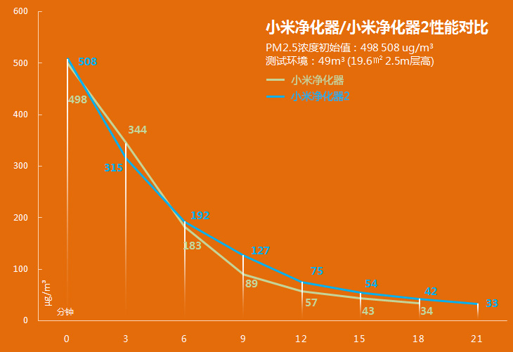

Official site : http://www.mi.com/air2/
Key take-aways :
Measurement of levels in a 49 cubic metre room (or 16.8 sqm HDB, 3.6x4.6m or those new 4-room BTO Master bedroom size).
Can you wait that additional 3 minutes (21 vs 18 min) when you suddenly get hit by very heavy haze like 19th Oct 2015's WEST 471 ug/m3?
  可以看到小米空气净化器2在21分钟时将19㎡环境下近似500ug/m3的污染浓度净化到35ug/m3以下。两个数字中前者是国家PM2.5严重污染标准的上限数值,而后者则是空气质量为健康的最高限值,也就是说小米空气净化器2可以用不到21分钟的时间将极为少见的严重爆表污染状态净化到健康标准,而小米净化器一代依靠更高的CADR值在18分钟完成了净化工作。小米净化器2虽然慢一些,但效率依然不错。
I have the 美的KJ30FE-NV2. It is CADR 318m3/hr if i am not wrong.
So as you can see, not a lot of difference. XM1, XM2, KJ30FE-NV2 are all in the same ballpark. The Samsung AX40 would still be in the same ballpark probably. You would not notice much of a difference in real life usage, even with a laser particle counter. The leakage from the windows, say whether or not it's closed properly, during a heavy bout of haze makes a bigger difference, as some of us with meters have found out with our measurements in 2015 Unless if you bring in a heavy hitter AP like the 750 m3/hr 352 X80 air purifier, then yeah there's prob a diff.
