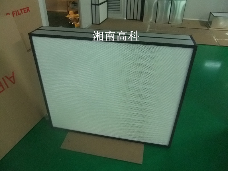

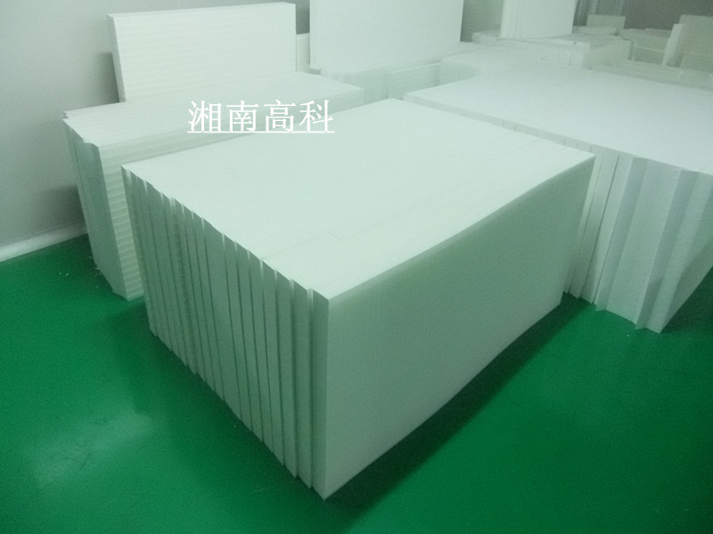

1pc 610x610x50mm taobao filter = 4pc Samsung AX40 (11 inch by 12 inch). 4PX Shipping costs RMB132 from SZ to SIN.
The filter is legit built, there is even a black colour flexi plastic = HEPA seal (not that you'd use it anyway).

Second pic is the wrapping from the manufacturer
Using the above filter try to DIY for your Sharp KC840/850, A40/A50 might be unsuitable. Coz the cavity is just 1.75" thick. The filter media itself when taken out of the frame is about 1.85" thick.
This is the exact replacement for the KC-840 or A40. Original is 370mm x 234mm x32mm.
I don't think it is H13 though, more like H10-H11 quality. Still capable of filtering 0.3 microns. It's definitely more than good enough for general use + light haze use....absolutely no issue at all.
Key point - damn cheap to tompang to your taobao order
