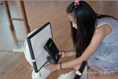

DIY Air Cannon (fan + HEPA) removes as much PM2.5 and PM0.5 as IQAir.
Particle Counting - New Tests! Can a 450 RMB DIY remove as much particulate as a $1,000 IQ Air?

If Sharp A28 they don't wanna fix for you, you'd just tie the Sharp A28's HEPA-10 grade filter to the fan.
Yes, that'd work.

Bought 8 filters in total. I have ALWWed the seller, they are using H12/HEPA-12 quality filter media.....hence that's 99.5% @ 0.3 microns thereabouts.
Not the other one who was using F9 which is lower grade.
544/8 = RMB 68 each on average. 30mm and 39mm thickness. Not too bad. FZ-200 model is for the KC-840 and A40.

Actually H11-H12 is good for consumer home air purifier use. Esp if you can increase the depth of the filter by about 30%. H11-H12 has a slightly lower airflow resistance. But not so critical clean air output use.
H13/H14 is more for cleanroom/pharma/medical operating theatre use, be it for the middle stage or end stage filter. They have extremely clean environments. Even the cleanest homes cannot appreciate the 99.95% output of a good H13 system.
