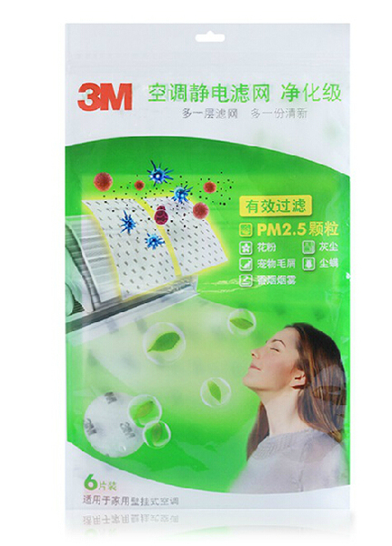

Ok, one more lobang for the bros here...... can get 3M Filtrete. Last time used to get from Amazon with freeship, 38cm x 60cm for usd4.97.
And there used to be an even bigger 152x76cm for just usd14, but OOS for very long liao.
Try to stick it so that it's behind the aircon net filter. So this 3M Filter does not get the coarse particles. Just it for your other rooms or as additional augmentation to your air purifiers for excellent quality air on days that are > 100 ug/m3.
http://world.taobao.com/search/sear...CAXRZeAt9Ds5J&callback=__jsonp_cb&abtest=null
Get these 2, I have tested the green one.
6pcs of 22cm x 34cm each
http://world.taobao.com/item/24710520316.htm?spm=a312a.7700820.0.0.uAHrFm
http://world.taobao.com/item/17519581796.htm?spm=a312a.7700714.0.0.ebIvbw#detail
Performance looks good, only is coz it's a very small room with a big 9000 btu/hr FCU. This is for the green one (you can see the 3M prints on it)
Versus the Amazon 3M Filtrete, which is the same type you'd find in local DIY stores like Homefix. Basically same performance
The purple one could be a tad better, not sure. Have not bought it.
PS. This can only be used in an aircon FCU that is clean and have good airflow. Else you are going to risk freezing the coil, leading to $$$ repair.
