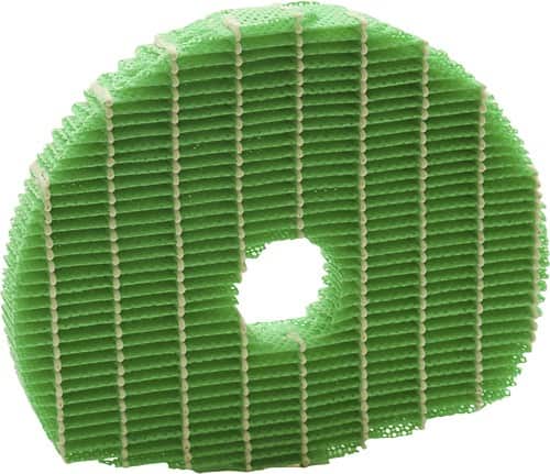

Yep, I don't use the humidifying option too. Coz seriously even with the air-con set to 25 deg C (pretty ok to us liao, coz our air-con airflow can be aimed at our bed) it's just nice at about 50% RH. And usually it's the initial 2-3 hours that's ~ 50%, by 3-7am it would rise up to 70%. That's what the hygro says.
Else the tank receptacle and all the plastics need to wipe and wash once every week.
The water wicking wheel is designed such that it is not wet when the humidifying option is OFF.
Basically it turns round and round, the bottom part would be immersed in water. So there is this part where it's flat, that position would be the Humidifying OFF position. Very simple contraption.
