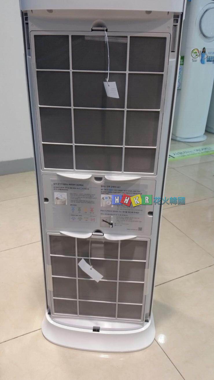

Those spongy filter would cut your airflow. Heck, even slicing out the AC filter of the original AX40 would boost the airflow to 350+ m3/hr.
Already have prefilter, relax. Everything is well taken care of.
Use that "PF75" electrostatic filter that you've gotten from Taobao on your fans or something. Loud though. :D
Anyway, I managed to search for the performance of that 蜗牛 electrostatic filter. I did measure once before. It's about half the performance (CADR) of the 3M. And yes, it has quite severe cut in airflow, even more than the 3M Filtrete when I measured with my anemometer.
