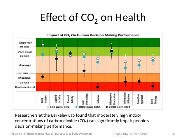

Peak value reached overnight of 6hr sleep = 2179 ppm of CO2. After waking up and continuing to PCW (like now), it continues to rise to over 2,200ppm 1 pax in HDB bedroom only.
Due to cold air (aircon) seeping through the air gap beneath the door, it stabilises in the 21xx range.
My windows has double rubber seal, pretty air-tight (thunderstorm time, I'd need to keep it properly shut & locked else would have that howling sound coz high wind/high floor).
I think it is very difficult to maintain below 1200ppm, unless you keep a very large gap of 2-3 inches open for the door and using the cold air draft from the aircon to assist in gaseous exchange.
Note : CO2 toxicity is reached before insufficient oxygen condition is reached.
The U.S. EPA CO2 exposure limits: The U.S. EPA recommends a maximum concentration of Carbon dioxide CO2 of 1,000 ppm (0.1%) for continuous exposure.
- ASHRAE standard 62-1989 recommends an indoor air ventilation standard of 20 cfm per person of outdoor air, or a CO2 level which is below 1,000ppm.
- NIOSH CO2 exposure limits: NIOSH recommends a maximum concentration of carbon dioxide of 10,000 ppm or 1% (for the workplace, for a 10-hr work shift with a ceiling of 3.0% or 30,000 ppm for any 10-minute period). These are the highest threshold limit value (TLV) and permissible exposure limit (PEL) assigned to any material.
- NIOSH's recommended CO2 exposure limit for 15 minutes is 3.0% or 30,000 ppm .
- A CO2 level of 4% (40,000 ppm) is designated by NIOSH as immediately dangerous to life or health.
-OSHA has set 30,000 ppm of CO2 as a Short-Term Exposure Limit (STEL).
