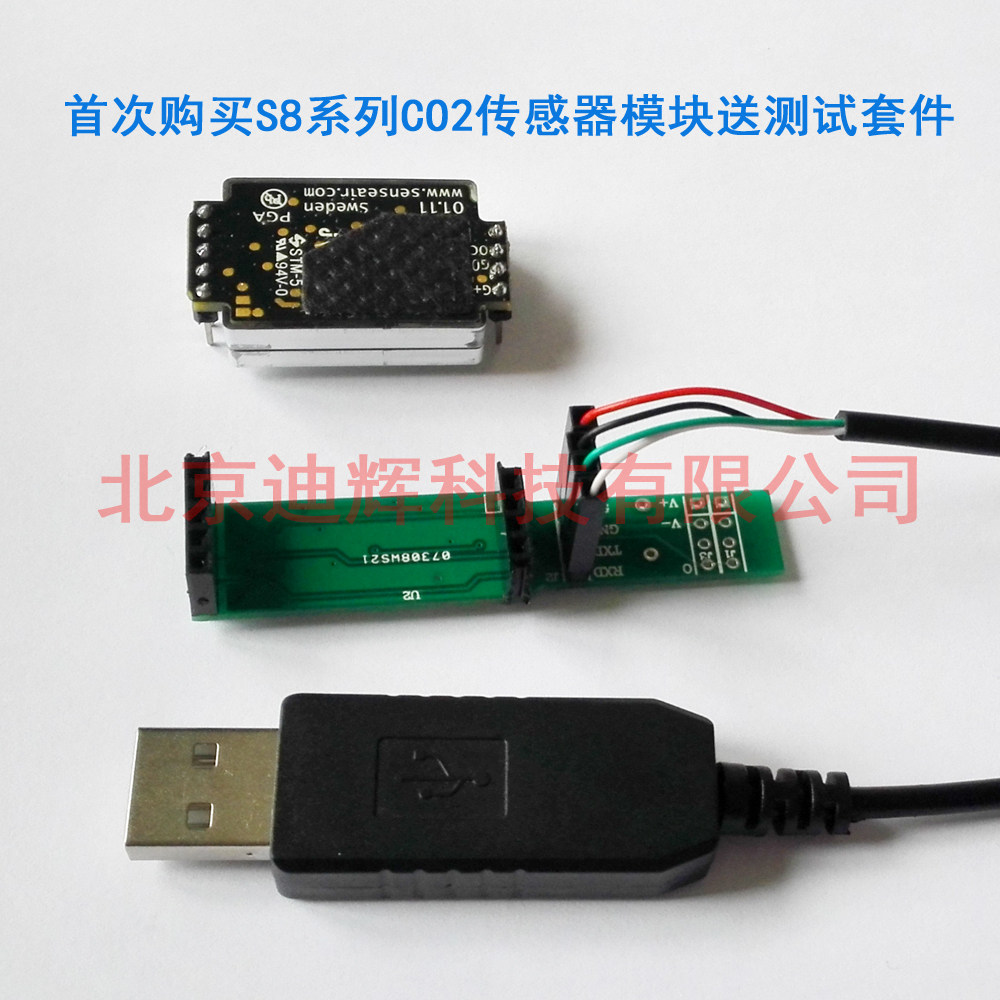

Yes ac with ap rm...thing is i feel comfy lol
I think it's the same thing as desensitisation. Now with some reference level, I finally can put something to it.
Eg, last time I didn't care much about waking up and though the room feels stuffy (my wife also said so), we didn't think much about it. Now we know it's basically the CO2 levels (and possibly the correspondingly lowered O2 levels).
So can fine-tune this.
I think > 2000 ppm then I really would feel it. Less than that, not so. Tonight I will see if I can maintain it below 1500ppm and see how's the feeling.
Last time was really shooting blindly, more on PM2.5. CO2 is more for comfort (together with humidity and temp)

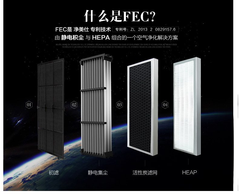

Electrostatics have already been discussed before a couple of times. Not that they don't work. The CADR is just lower than the HEPAs. The main advantage is that they are literally noiseless (those models without fan)
小二顺便说一句贝昂空气净化器还有一个隐藏大招,这货是靠离子风来带动空气循环过滤的,机器里没有风扇,所以工作的时候完全没有声音,不会打扰睡眠哦。
The Poeima P500 is approx. 180 m3/hr CADR. And I'll leave affordability calculation to you, with regards to the 1k+ price tag of this unit. No comment, for some can afford 4 units around the house coz he/she values the zero noise level more than the few thousands of $$.
