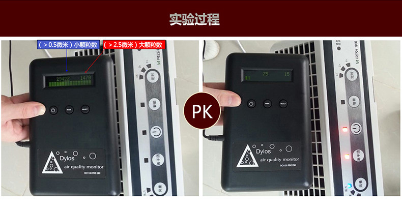

The M-fresh model. But the thickness of the HEPA filter itself is pathetic, I think at most 0.5 inches nia. But I think overall is well over 1 inch if you include all those simi catalyst and activated charcoal, just get the Fellowes (Made in Korea) from AMZ as replacement ba..... don't get from taobao liao.
And interesting claim by the 3M HEPA used in the M-Fresh model 6334 (down to 0.09 microns).

The issue is also testing. The Dylos laser particle counter which is the cheapest device that one can get, costs like what....usd199. :) No amateur here or elsewhere is siao enough to get one and test.
Of coz the claim is that they have tested (and I do not doubt that). But there is always the bait n switch risk over time, plus how the sellers act over time and to make a quick buck with the main distributors, that;s also difficult to say.
