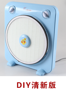

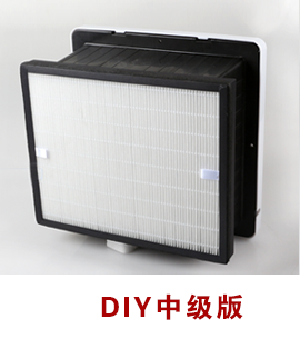

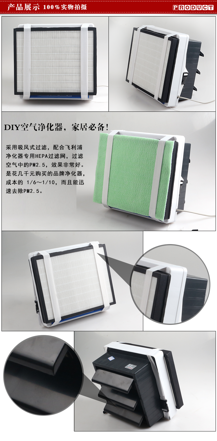

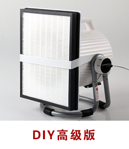

Another interesting concept for DIY HEPA purifier. Can try it yourself to put into office/room for standby purposes. It's pretty small.
HEPA can get from Amazon, or if you trust taobao's Made in China OEM HEPA quality (shd be pretty ok, maybe HEPA10-12).
DIY
WussRedXLi
Jun 15, 2001
95,469
11,647
RMB19/SGD4 HEPA 10-12(probably) circular filter. Free shipping to 4PX SZ forwarder etc.
Limited to 1 per customer
Specs 275mm diameter, 15mm thickness.
Standby to scotch tape to your 230mm outlet iFan or Vornado or SGD19 Morries fan that you can get from GIANT, as an additional aid to your Sharp A50/Samsung AX40 etc if you were to lug them to your living room.
Caution, don't whack during sleeping or unattended. V slight fire risk. Only for "emergency usage" like > PSI 200.
SGD4, and probably just some 300 grams in weight so forwarding feels would be v low. Can't complain.
