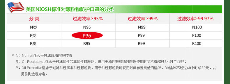

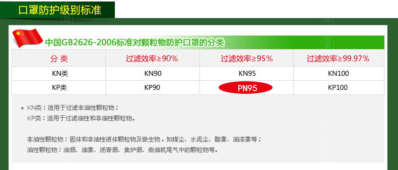

Can get 1 box of 3M 9002V to try. KN90 standard, ie 90% instead of 95% for N95 or 99.97% for N100. PSI500 -> PSI50? Still sounds good enough to me, with perhaps a small improvement in the reduction of air resistance. Also it's valved.
It's quite light, so tag it along with your next 4PX shipment from SZ to SG.
http://detail.tmall.com/item.htm?sp...711083862&rn=1e2fb87517c2e6de22c39c8131fa2d7d
Fit looks pretty decent, it's not the turtle hardshell 8210. Can be folded.
