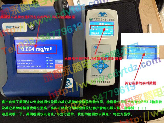

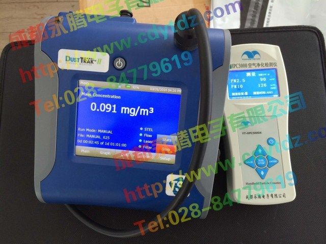

Check out the youku video in the below link that I am sharing. Got demo of laser particle counters and measurement of a Tiong air purifier. Formaldehyde (Jia3 Quan2 甲醛) dropped from 0.25 micrograms per m3 to 0.09 micrograms per m3.
PM2.5
Comparison with a RMB 60k DustTrak laser particle counter.

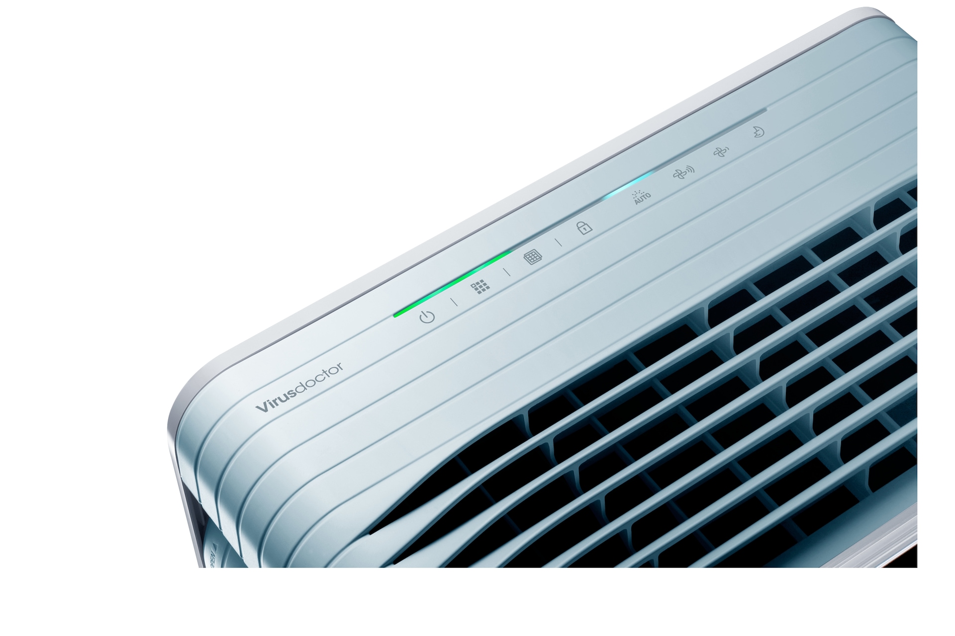

The -ve ion ioniser (in Samsung speak that's the Virusdoctor) is denoted by the circular circles icon. You can see this on the AX40.
On the AX041FCVAUW, there is no such icon.
