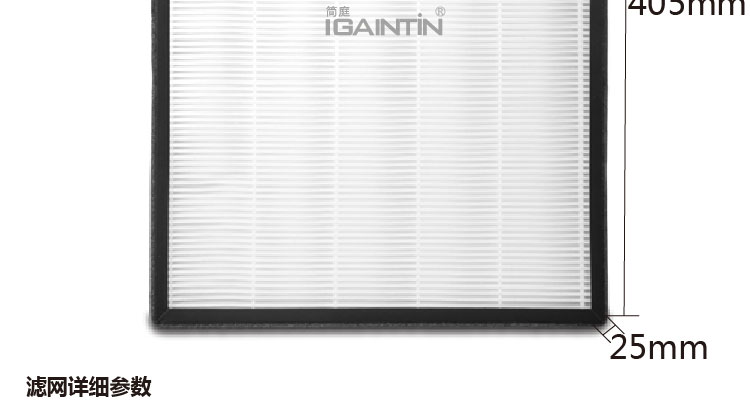

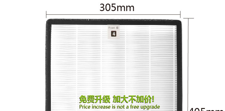

Hi,
Is the edges easy to cut? It seems to be made of metal frame. I cant find the sharp filter so think of getting this.
They are pretty easy to cut. But now with taobao, I would not recommend that.
But nowadays you can get HEPA filters from taobao. Some are H11 grade thereabouts, some are between H12 and H13.
All will work. Just have to find a size that's bigger.
The is by smartfilters, they have tested theirs with a Dylos laser particle counter to be approx. 99.3%, so that's H12 thereabouts.
SmartAir
They tested other taobao HEPA filters, some are only like about 92% clean at the outout.
Anyway, this is one of the biggest that I can find.

Hi,
i am afraid that the ones from taobao fake hepa.
WussRedXLi
Jun 15, 2001
96,259
12,071
Hi,
SmartAir one confirm not fake. Actually 99.9% of them are not fake, maybe just work a wee wee bit lousier than a true H13. But seriously in real life, you won't notice one lah.

12,071
Then the taobao one fits. 40.5 (16") by 30.5 (12") and depth 1 inch.
hepa
Got youku video inside, efficiency looks good as it clears the smoke as well as does well on the Dylos laser particle counter (it will work better in your Sharp). Just have to take it that it works as we do not have pm2.5 monitors or laser particle counter (can get one if you one....I have an el cheapo one lol!)
