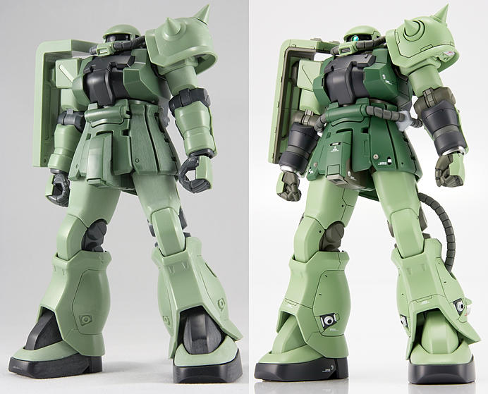

anybody familiar with detailing their gunpla ?
looking for a chisel-like and round-depth effect. what tools to get for it ?
d531ad_2b7ab65cc27b40088c7654b487d2c449.jpg_srb_p_693_559_75_22_0.50_1.20_0.00_jpg_srb
eg the knee, thigh area where there's small hole.
and shoulder spike there is a small rectangular shape.
any one knows how to achieve this ? what tools to use ?
