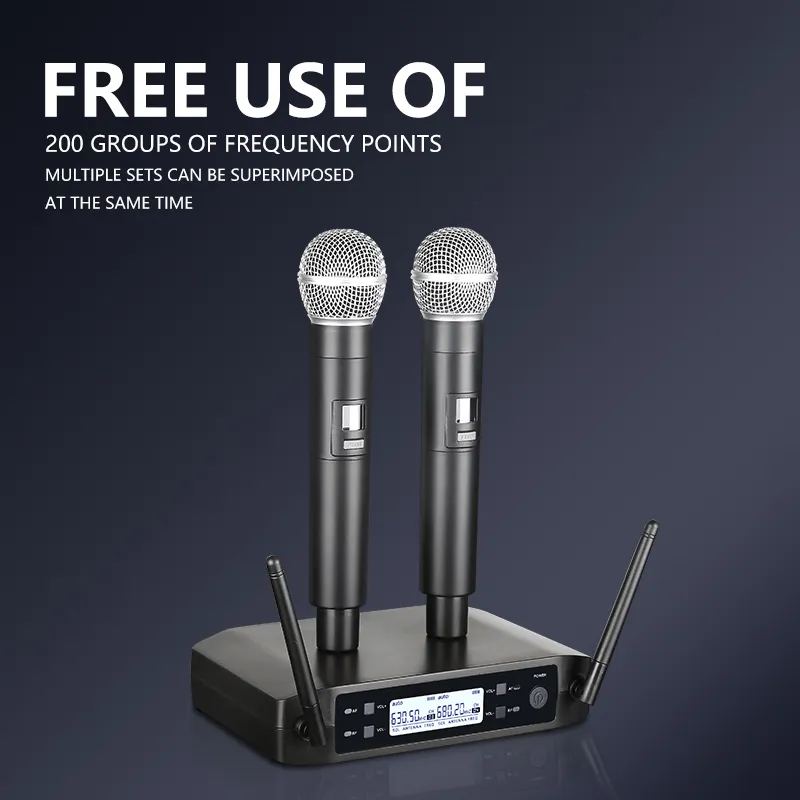

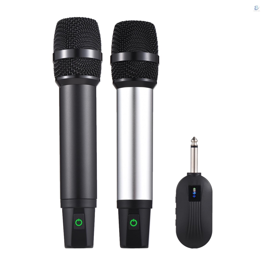

Hey guys... u know there are 2 types of cordless mic receiver sets for karaoke right (see below)... if u want to connect either one of them to a an amp or powered speaker... what kind of input jack/s must the amp or powered speaker have? Is it just need an ordinary audio-in jack or does the amp/powered speaker need to have a mic interface with mic-input jacks?

If these 2 mics jacks are mic output(u will literally see mic as the output) it usually means it's not amplified, then u need to connect it to the mic INPUT of an amp, before the speakers.
Some wireless mic receivers actually have an AUDIO OUTPUT. Those can work with AUDIO INPUT of amps and powered speakers. I'm using these in a portable setup.

R u referring to the 2 mics output jacks on the 2 wireless mics receiver sets in the pictures I posted?

Yes. Referring to the 6.35mm mic jack in the 1st pics of ur post. Ur 2nd pic doesn't show the mic jack but I'm guessing it to be the same.

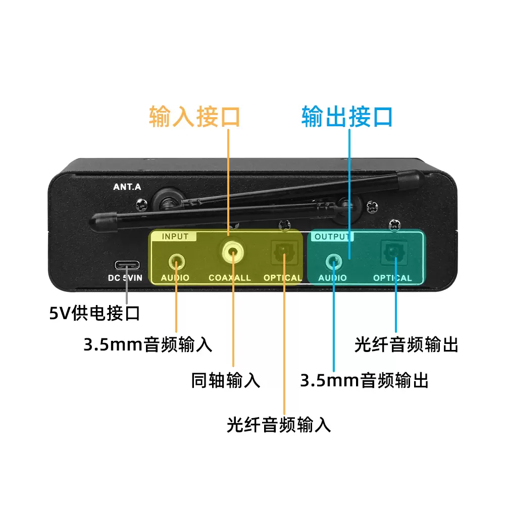

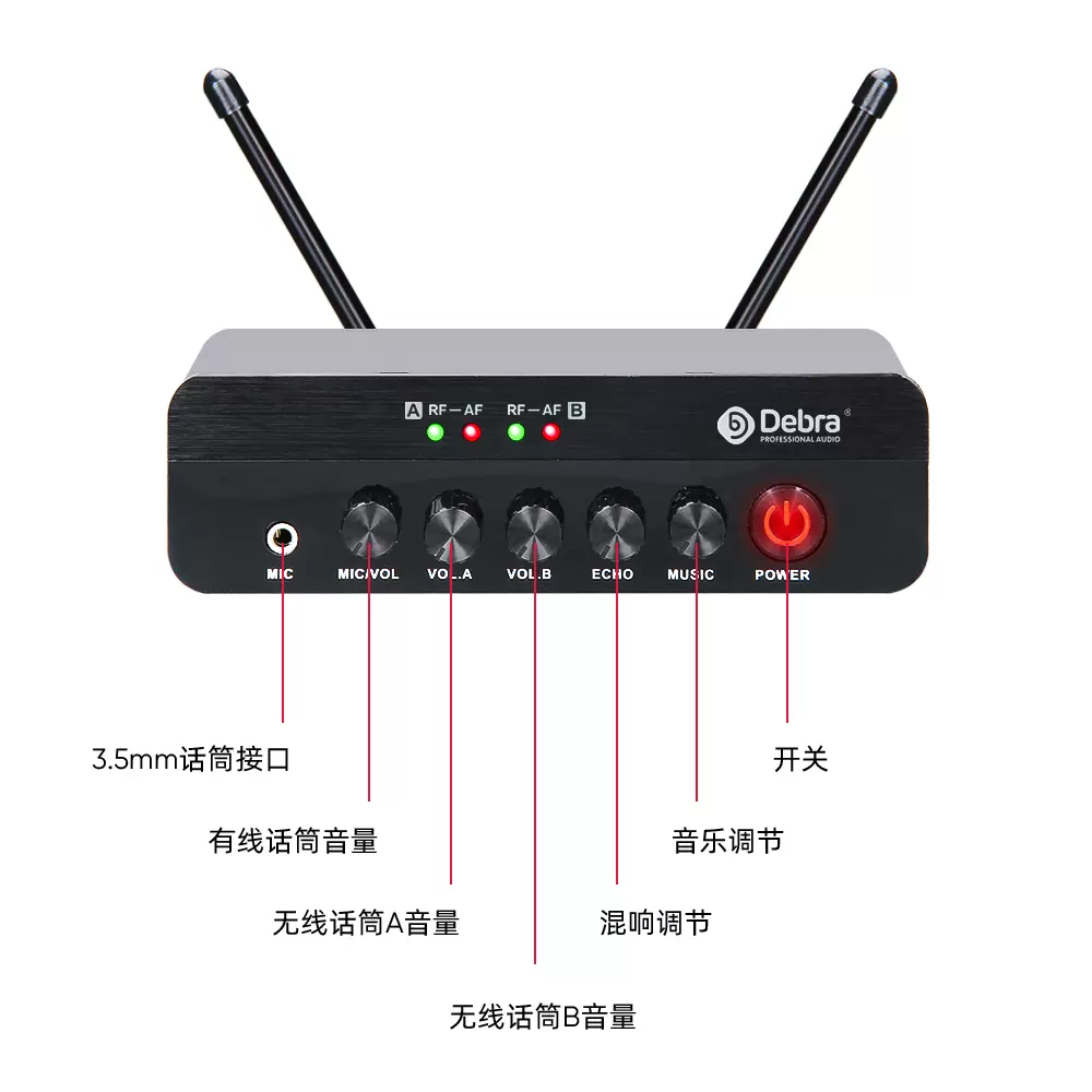

Yes. In the sample pic below showing a wireless receiver + built-in amp, mic refers to MIC input:
The pic below shows the same device with ports at the rear, showing both 3.5mm INPUT & OUTPUT labelled as AUDIO :
PS: I'm using this device to connect the GREEN AUDIO OUTPUT(Above) to the 3.5mm AUDIO INPUT of a portable speaker and it works as I intended to be.

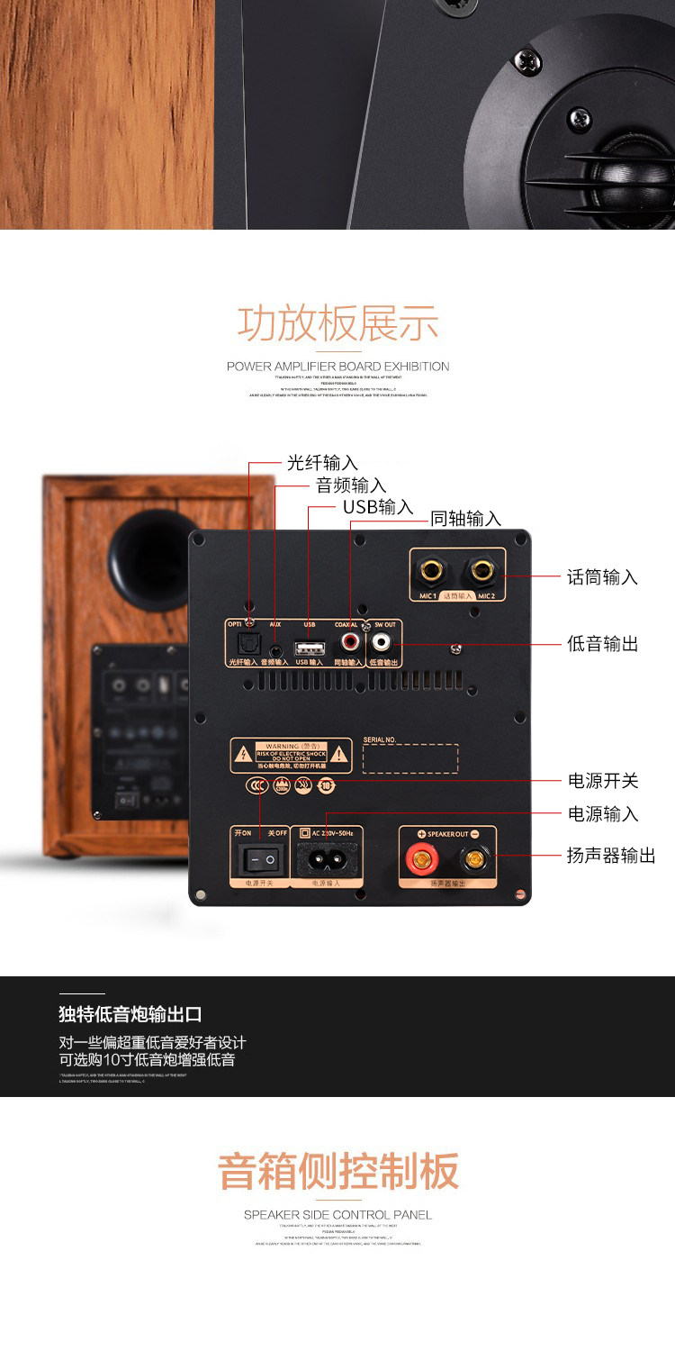

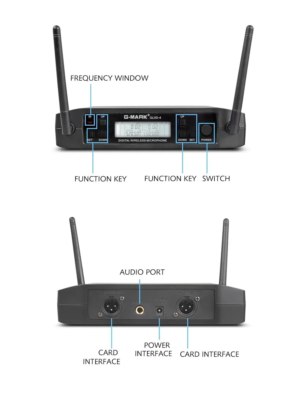

Ic... I've just ordered a mic receiver online... u can see it below... if I wanna connect the AUDIO OUT from it to the MIC IN of a powered speaker like the one u see further below... will it work? Is it like AUDIO OUT from a mic receiver has to strictly plug into an AUDIO IN of the powered speaker or the MIC OUT from a mic receiver has to strictly plug into a MIC IN of a powered speaker?
Do any of u guys know?

Hard to tell. It seems u should connect the XLR outs to the mic in of the speakers and music source to the aux in. as for audio out , better refer to the manual to see if it is line or mic level outputs .
Actually the audio source can be plugged into the Coaxial or the Optical inputs as well right?
Oh u mean the audio port at the back of the mic receiver could maybe be used as a mic output?
the aux, coaxial and optical is probably on the same mixer channel. so likely u can only switch between them.
the audio out of the mic receiver logically should be mic output, since it has no other input source. So if u have a separate mixer with 2 line level in, u can output to the aux in of the speaker.
Ps. Without seeing the manual this is just logical guess .
Do u mean that since the only input source for the mic receiver are mics so the audio out on it should be a mic out? But if u see this post by @theoryjack below... the audio in and audio out on his mic receiver are according to him normal audio in and out...

They are not the same product. Yours is a basic mic receiver. The audio out is definitely a mic output. On closer look it is a quarter inch jack, likely it is mic level output. Means u need to connect it to a mic input and not a aux input. otherwise it is very weak and noisy when the vol is up.

Ic... I'm thinking of getting a pair of active speakers that has only 3 types of inputs... they are optical, coaxial and RCA... will I be able to connect my mic receiver (ie. from XLR-out or mic-out) to any of them?

No, as I mentioned the signal is too weak to connect directly to a speaker without mic in. u need a mixer, or a speaker like Bose S1 pro with built-in mixer so that u can hook up ur karaoke music on aux in and mic receiver on mic In and listen to them together.
