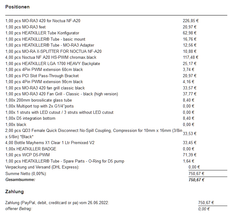

Jesus its like $1800 SGD not including tax and I'm still missing tubing and waterblocks. The last time I did this with a whole bunch of EKWB stuff cost like $1000, it only made the i9 7900X usable.
waterblocks also go heatkiller, they are solid, reference 5090 waterblock soon. not like you need local warranty https://forums.hardwarezone.com.sg/...ected-rma-lol-whats-the-next-upgrade.7075357/
bite the bullet! it is one time costs, should last many builds
eur60 DHL is quite cheap!
lol wtf that's so expensive. But i guess mora IV is more expensive since it is more modular.
This was for fully loaded mora 3 420 w/ grilles, feet + HK Tube w/ 1 d5. If take away the heavy backplate and qd3 total is under 700 euros. I added some stuff because last time hit 750 can get free shipping lol. But yeah good for longevity, can be adaptable to any wc build you do.
