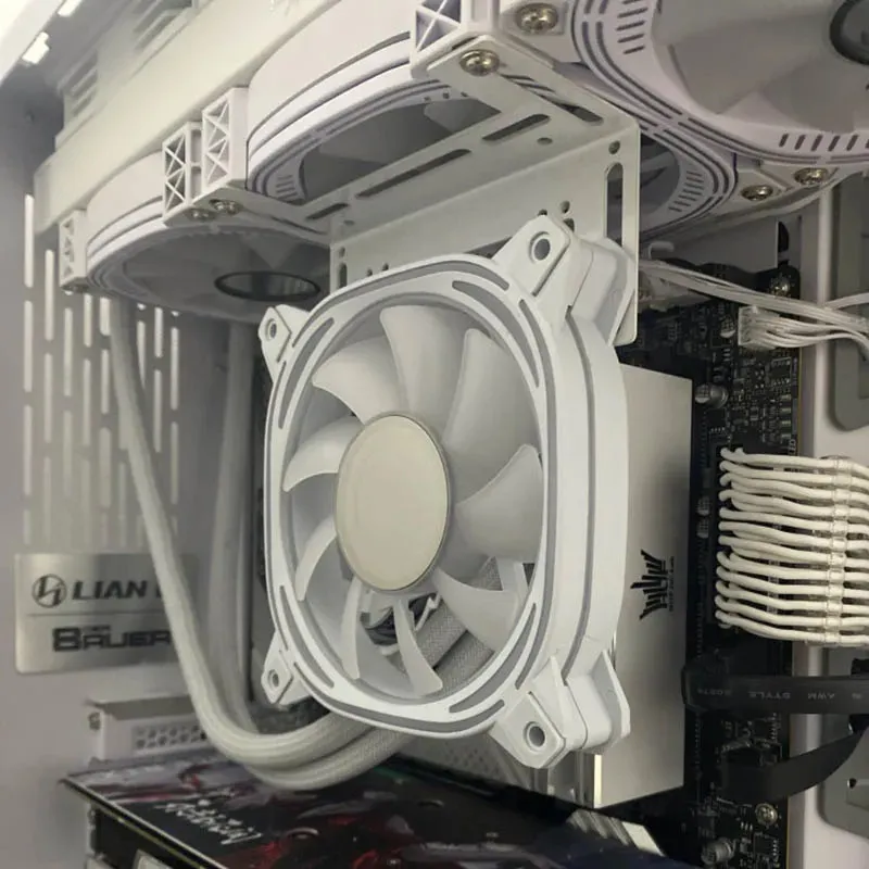

tiagong is paint thiner. for single rank ddr5 is harder, make sure to work on the empty pcb side because that side using adhesive tape. the memory side with pads should easily come off.
can follow these user experience and try the kimdoole heatsink, got good feedback on air, it has full coverage of memory chip. some stock heatsink dont even cover fully like my teamgroup, can see one side, parts of ram chips exposed.
https://www.overclock.net/posts/29280234/
https://www.overclock.net/posts/29272750/
https://www.aliexpress.com/item/100...RagzXH0x&utparam-url=scene:search|query_from:
mora is expensive but also need a lot of planning and monitoring time
so can try bare ram chips -> bigger fan -> kimdoole -> then mora
see which steps enough for you to stop. :o
fkchon
Oct 9, 2022
981
498
hmm don't have paint thinner at home can just use 70% alcohol or should I just order paint thinner
ya I will try bigger fan first then ram naked, not sure if I'll get kimdoole if I'm getting something might as well get best
So far running XMP settings temps top out at 51 which is still decent
I really don't like the temperature variance between the DIMMs on the case
DIMM0 is starved from good airflow, DIMM1 eats hot air from 5080 what to do?
Nice clocks.
If you're not having errors, I guess you're fine.
Don't increase TREFI further as you'll bound to have errors. It's a temperature sensitive parameter. How are your DIMMs cooled now?
I'm using a Corsair Vengeance cooler with BITSPOWER Heatsinks. Enough to cool down up to 1.6V under 50 degrees. I'm only at 40 degrees after 3 cycles of TM5 1usmus at 1.55V for my 8600C38.

these are the XMP clocks :cautious:, when I got the build setup first day I did 9200C42 (open bench but wasn't stable)
right now I have some of these jonsbo memory cooler, the QA isn't very good so its not on the DIMMs directly, they're running 4000rpm and I can't hear them
I'd definitely tear down and use better heatsinks. I have the BITSPOWER ones and they are very good. I have a guide on the thickness of the thermal pads required if you want to go down that route. Here it is:
https://www.overclock.net/posts/29097475/
I like the BITSPOWER ones because so far they've worked very well for me. I also have the option to watercool them since mine came with the waterblock together with the kit but I didn't find a point in doing so since my CPU has the SA bug so I can't run past 8600 without increasing my SA voltage past 1.23V.
If you really are concerned about ram temps, just block the ram :) it will run around 2-3c above coolant under full load which is around 5-7w.
