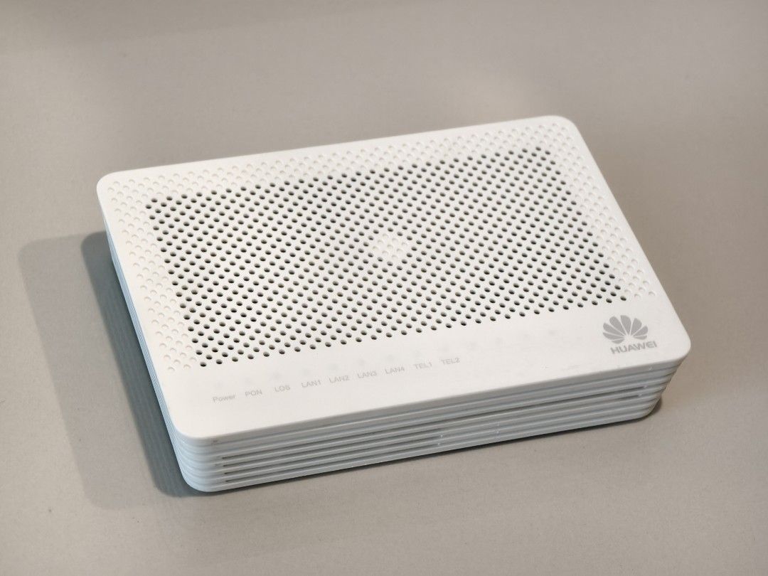

My new ONT for recontracted 6gbps plan
It's a Huawei OpiXstar HN8250Ts-20
it's smaller than my old 1gbps Huawei white ont
like not much of ventilation holes..
my current 1gbps one even the top surface got many holes for heat dissipation..

The current ONT I have is the Huawei EchoLife HG8240H5. Will they replace it with a new one for the 6Gbps plan?
xiaofan
Sep 16, 2018
29,713
8,019
Huawei EchoLife HG8240H5 is based on GPON technology and it does not support the new XGS-PON based 3Gbps/6Gbs/10Gbps plans.
So you will get the new XGS-PON ONT, Huawei OptiXstar HN8250Ts-20.

GPON
Model: HG8240H5 (newer ONT replaced 2 years ago)
Dimensions: 31mm x 166 mm x 113 mm

Model: EN8250Ts-20
Dimensions: 34 mm x 178 mm x 117 mm
I have the newer GPON ONT so the XGSPON ONT is a bit bigger in my case.
