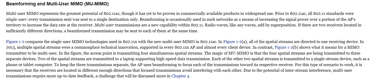

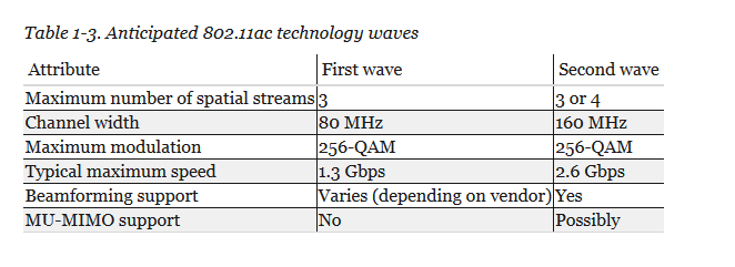

More juicy rumors ~ what to expect from CES 2014?
The next generation of 802.11ac routers aka 2nd Wave 802.11ac
1). More spatial streams ~ 4
2). Channel Bandwidth ~ 160MHz
3). Maximum Modulation ~ 256QAM
4). Typical Maximum Speed ~ 2.6Gbps
5). Beamforming ~ Yes

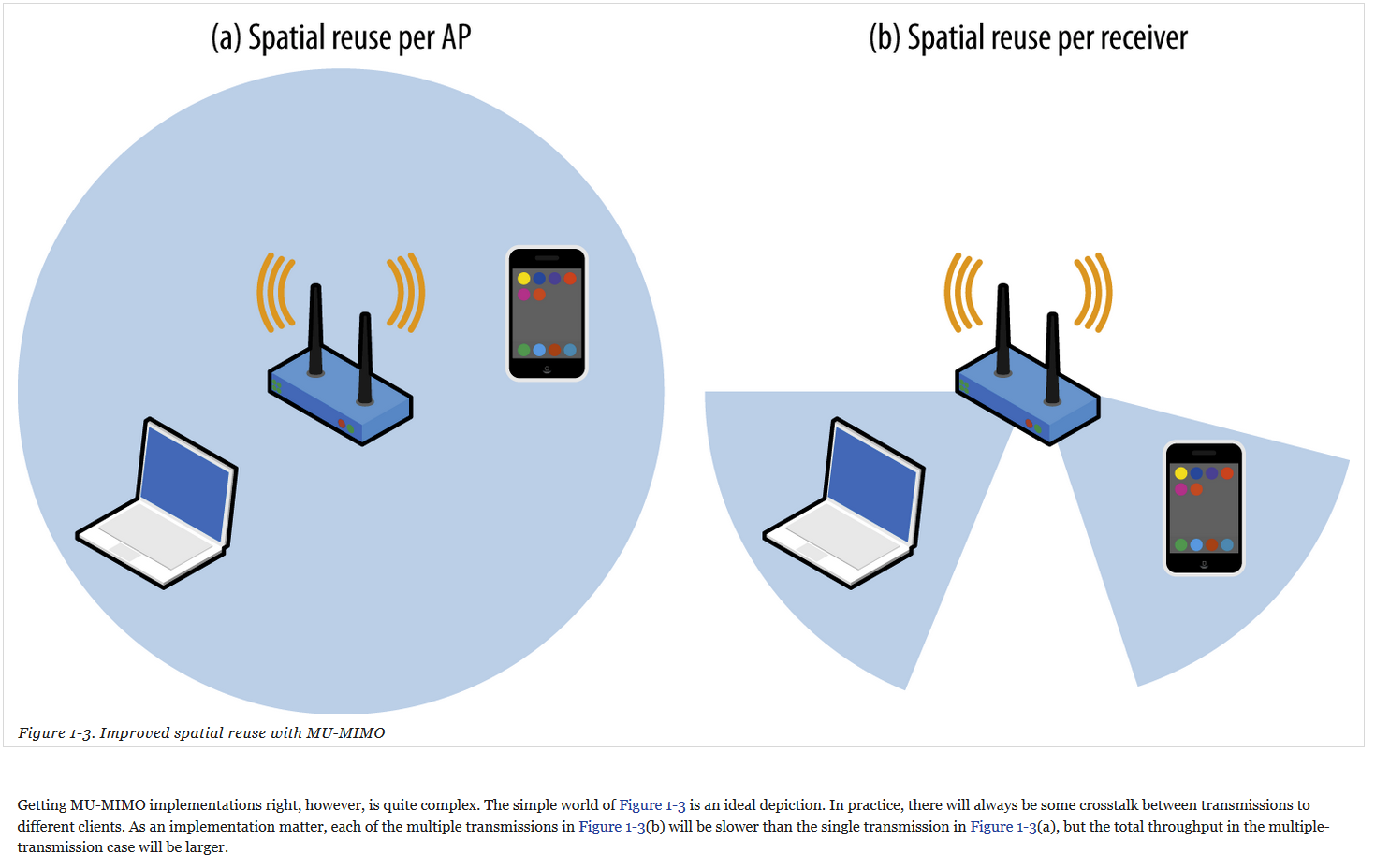

6). Possibly MU-MIMO :D /excited ^^
More on MU-MIMO explained

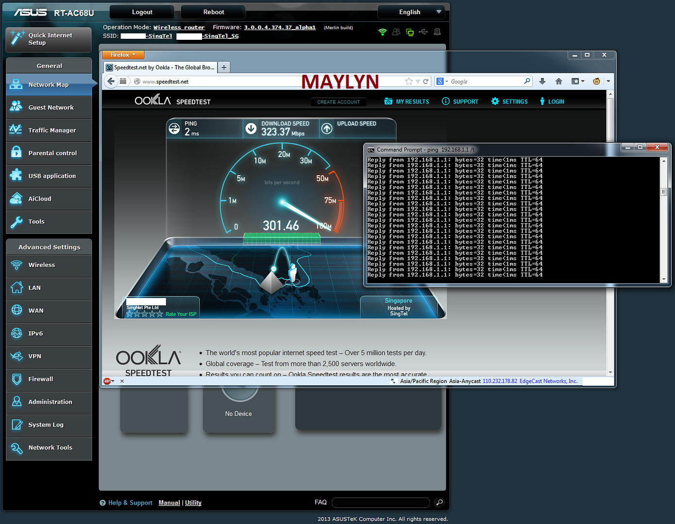

@maylyn
I noticed merlin has released a beta for the 68u on Xmas Eve. Is that the same beta as released by asus ? Eg build on the same SDK?
Nope, the 3.0.0.4.374.36 beta 1 (Winter Knight) Merlin build is still based on the ASUS 3.0.0.4.374_339 GPL source code and the SDK used is one version lower than the 3.0.0.4.374_501
The incoming Merlin build ~ version .37 will based on the ASUS 3.0.0.4.374_501 GPL source code and the newest Broadcom SDK. It's still in an alpha stage and testing have been commenced to test the whole firmware stability + RMerlin's usual dose of goodies :p
